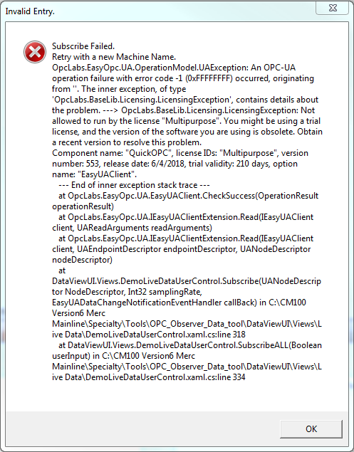

16 May 2019 20:31 #7379 by support
I am glad it works.
And yes, the minimum framework version has increased.
16 May 2019 20:15 #7378 by WJurasek
I got it working! so I had taken the Dll's from the Bin folder instead of the Assembly Folder so after a framework change to 4.6.2 everything started working again! Thanks for the help!
16 May 2019 17:04 #7377 by support
Installing and running the newest trial, as you have done, should have resolved the issue. Are you sure you have re-built the project with the newer assemblies?
Is the error in the attached picture from before, or after installing new version? If it's after from the "before", please post the one you are getting now (although it might look almost the same at the first glance).
16 May 2019 15:01 #7376 by WJurasek
Hello! I downloaded the trial version for development last year in August and it worked well up to the end of December where I took time off for schooling. Now I'm back at work and trying to continue the development on my program and when I try to subscribe to the Machine this error appears. I have gone to the website and downloaded the most recent trial version i could find and the problem still persist, how may i go about fixing this issue?
