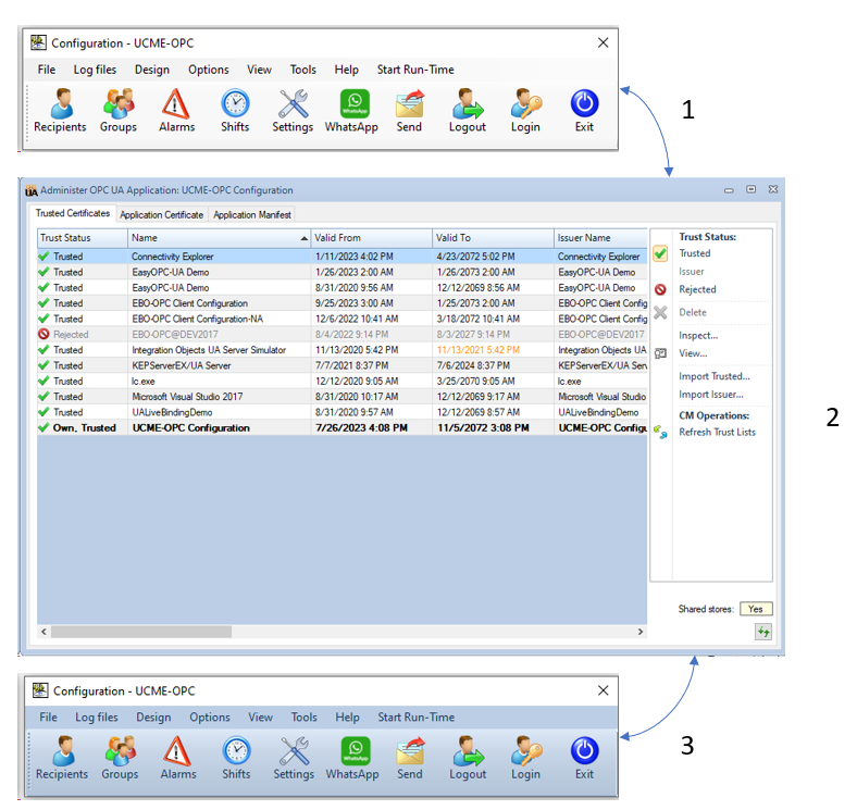

Our form changes its color after the Administer OPC UA dialog is displayed

What happens is that Microsoft has a single global setting for the appearance of toolstrips: ToolStripManager.Renderer , learn.microsoft.com/en-us/dotnet/api/system.windows.forms.to...nderer?view=netframework-4.7.2 . The value of the property applies to all toolstrips in the whole application at once.
You are using one setting (the default setting), and the library we are using (Krypton) uses another setting. There is no way of having them both at the same time.
In version 2023.2, we will still set our own appearance, so during execution of the dialog, all toolstrips will change. That should not be a big deal, since the dialog is modal and while it is executing, controls outside it are not functional anyway. But we will revert the setting back when the dialog is closed, so your application will look the right way afterwards.

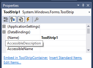

    10 Oct 2023 05:38 #12278 by micham
    The control is a ToolStrip. See below.
    09 Oct 2023 18:05 #12277 by support
    If it so, what type of control is the tall horizontal bar with icons? So that we can try to reproduce it...

    07 Oct 2023 09:09 #12274 by micham
    Our form changes its color after the Administer OPC UA dialog is displayed .
    See the screen capture below.
    Any idea why?
