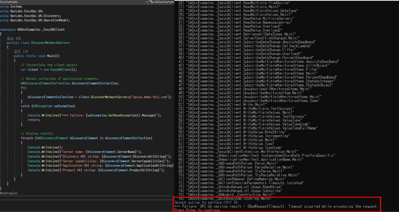

This can be either a timeout returned by the server (in which case it might only be possible to change it on the server side), or one of "our" timeouts. They are described here: kb.opclabs.com/QuickOPC-UA_Timeout_Settings . Most likely, this would be the OperationTimeout.
However, it is already quite high by default (2 minutes). The public servers are meant for testing simple examples for QuickOPC only, but anybody in the world somehow feels free to use them for their own testing and create high load there.

OPC UA browsing - DiscoverNetworkServer, DiscoverLocalServer Timeout setting
Hello
I'm trying to run the example in OPC UA Example. However, that example causes a timeout problem. Could you possibly set a timeout?
best regards.
