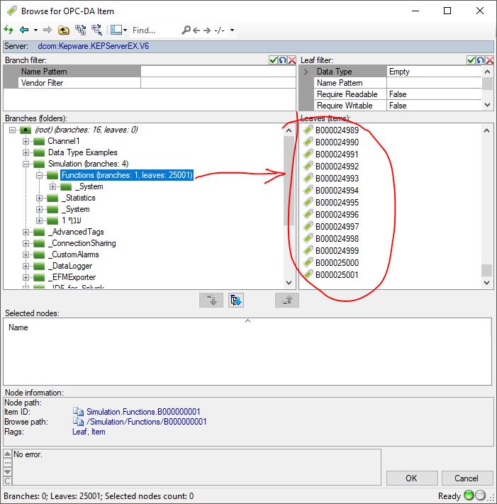

Note: I have 25,000 items in the "Functions" branch and 1,000 items in the "Channel1 > Device1" branch.
Note: When I browse to the same Kepware OPC DA server, there is no error. I am able to see all 25000 items. See attached screen capture.
To reproduce the problem, please try browsing the "Channel1 > Device1" branch using OPC UA browsing.

29 Jun 2021 15:10 #9852 by micham
One more problem after the upgrade to the newer version. When I try browsing the Simulation > Functions branch I am getting an error. See below. With OPC UA Expert there is no problem browsing this folder. See the attached screen capture. Note: there are 25,000 items in this folder.
Cannot lock the OPC-UA client session because it is not available.
+ The client method called (or event/callback invoked) was 'BrowseMultiple'.

29 Jun 2021 13:58 #9850 by micham
I tried it on my compute. When I try item browsing I get this exception.
Exceptions
Type: OpcLabs.BaseLib.Browsing.BrowseException
OpcLabs.EasyOpc.UA.Engine.UAEngineException: UA SDK error (Opc.UA.ServiceResult=0x80820000) in 'DiscoveryClient.GetEndpoints'. OPC UA service result - {BadTcpInternalError}. Error establishing a connection.
+ The error occurred when preselecting an endpoint for discovery URL "opc.tcp://Dell-i7mike:49320".
+ Some possible causes of this error are that the OPC-UA server is not running, or is not configured to listen on the specified port. Also, the network connection may be broken (cable unplugged?).
+ The endpoint URL string used was "opc.tcp://Dell-i7mike:49320".
+ The client method called (or event/callback invoked) was 'BrowseMultiple'. ---> OpcLabs.EasyOpc.UA.UAServiceException: OPC UA service result - {BadTcpInternalError}. Error establishing a connection.
--> {BadTcpInternalError}. An unexpected error occurred while connecting to the server.
--> {Bad}. No connection could be made because the target machine actively refused it 192.168.1.43:49320. ---> OpcLabs.BaseLib.Portable.CustomException: No connection could be made because the target machine actively refused it 192.168.1.43:49320
+ This is a deducted base exception.

29 Jun 2021 13:28 #9849 by micham
Sorry. The version is 5.60.107.1.
