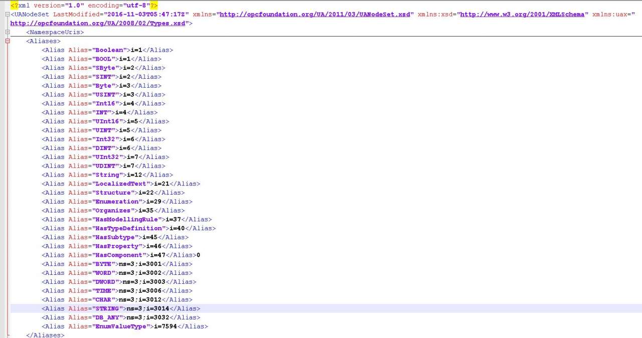

The picture you have shown is of the UA nodeset file on the server side. I think (but I am not 100% sure) that the Aliases might be primarily just for internal use in the nodeset (so that entities can refer themselves).
It is, however, possible that the server has used either the alias, or something similar, in the description string of the type. Have you tried to read the Description attribute of the type definition node?

In Siemens IDE I find posibility to generate opc.xml file where i fond, that Identifier 3014 stand for "String"
It is posible read this Aliases by your EasyOpcClient?

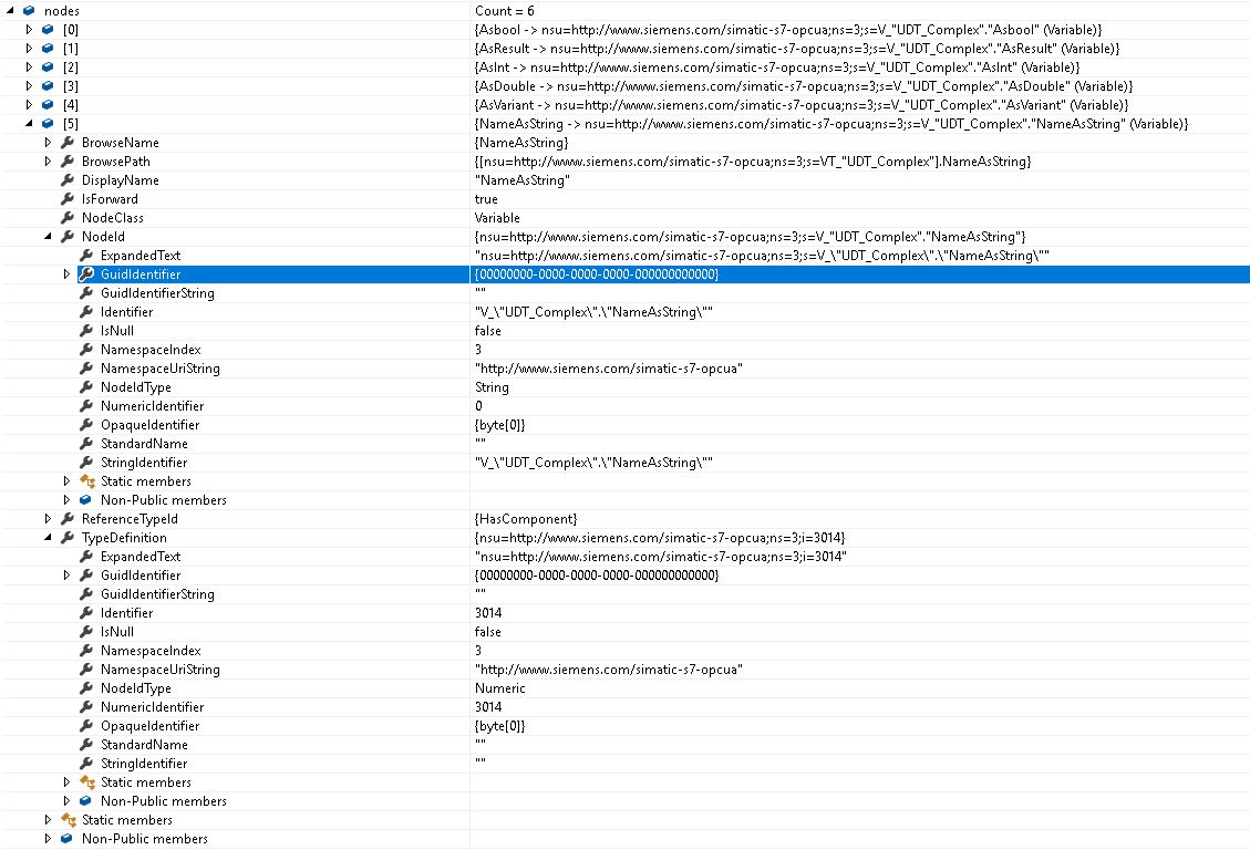

The TypeDefinition is indeed the Node ID of the type.
And, I would kind of expect that by browsing from there, you should be able to find the members of the type.
But, *what leads you to believe that you should see some more members*? I do not know what you expect, but to me it looks like that the actual type might be kind of atomic (because the variable name ends with "NameAsString"), and isn't it therefore correct that it has no further members?

Hello, I try to create c# Classes browsing OpcUa server on Siemens-Plc.
I have in plc Datatype (is a structure) "UDT_Complex" which contain this items: {NameAsString, AsBool, AsInt, AsDWord ...}.
I am able to list all type nodes (items in structre) by method "EasyUAClient.BrowseDataNodes()",
but I dont know which property in node describes the type that I need to create on C# side, or which method return it.
As You can see on the image Node property "TypeDefinition" containg other Uri ... and if I use this Uri in method "EasyUAClient.BrowseDataNodes()" it return empty node ...
So how to get data type for this value?
