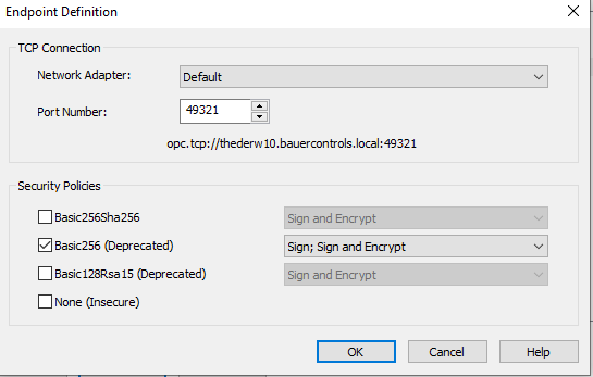

The OPC UA server does not trust the client. You need to explicitly tell the server to trust your client. How it is done, is server specific - consult the server documentation. Many servers will have some user interface to manage the trusted certificates. In such you will likely find your client's certificate under Rejected certificates, and need to perform some action to trust it.
It looks like you are using KepServerEX. In this case, switch to the Trusted Clients tab in the OPC UA Configuration manager, and handle it there.
Also, the server log should contain an explanation of why it does not accept the client certificate (but if you have not explicitly made it trusted, the reason is clear).

07 Aug 2024 20:41 #13002 by theder
I am trying out a sample based on some of your example programs on your website. I am having trouble connecting to a OPC Server via your library I have configured it based off what I followed on your documentation.
I have listed my server information down below I also have kepware set up to allow annonymous connections.
I also attached my sample project and the error I receive on failed connection if you need to look at that as well.
