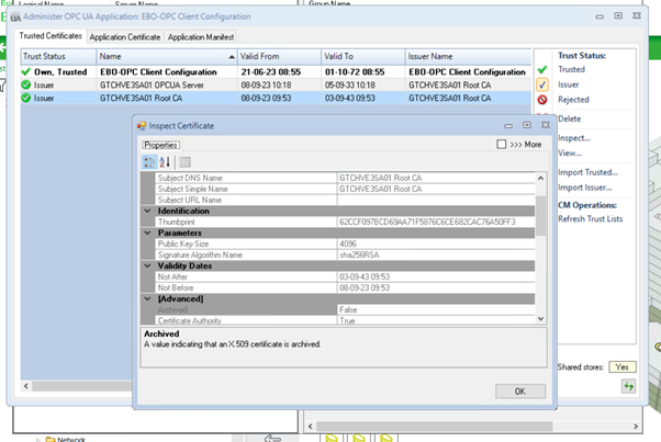

    09 Nov 2023 13:38 - 09 Nov 2023 13:41 #12341 by support
    next time, please create a new forum thread, for reporting new issues. You can always link to some other thread if there is a relationship.
    It is difficult to judge, because the pictures you have attached have degraded resolution. But after some enlarging, and some guesswork, I think that I can see that the reason (see picture):
    You have probably updated your software, and also updated its version number. The default QuickOPC behavior is that it constructs the OPC UA Application URI based on various pieces of information, including the version number. But, the Application URI must match the one in the application certificate - and in this case, it does not (the certificate has ....108.0 in it, but the software itself is ....109.0).
    Some applications benefit from this behavior (because it allows multiple versions of the application coexist on the same computer), while others do not (because they want the application to effectively remain "THE SAME" application after a version update).
    You can either:
    1) Regenerate the certificate (the "Create/recreate own certificate"); in turn, you will have to re-establish the trust on the server side (so that the server trusts the new client certificate). And, repeat this process every time the application version changes.
    OR
    2) At the beginning of your application, place a piece of code that will configure a more "fixed" application URI, such as that it does not change with version number changes [this does not resolve the very current instance of the problem; but it just addresses the same thing for all future deployments]. See: opclabs.doc-that.com/files/onlinedocs/QuickOpc/Latest/User%2...%20Application%20Manifest.html . In short, you need to set some URI string into the EasyUAApplication.Instance.ApplicationParameters.ApplicationManifest.ApplicationUriString property.
  • Last edit: 09 Nov 2023 13:41 by support.

    10 Oct 2023 15:54 #12286 by support
    Believe me or not, we are making progress. This error was expected. You now have a new client-side certificate, so the server needs to be configured to accept it.
    After you/your customer does so, you should be OK.
    10 Oct 2023 15:50 #12285 by micham
    Hi Thank you for your answers.
    See my response below. I still get an exception.

    10 Oct 2023 11:50 #12284 by support
    Hello, and thank you.
    Notes:
    - No wonder "Refresh Trust Lists" does not work; I have not instructed you to do that
    - The crash after exiting the dialog: This is clearly our problem, I will pass it onto the developer.
    But, from the screenshots I have enough information to proceed forward.
    Please do the following:
    1. Invoke the OPC UA Application Administration dialog again.
    2. Switch to the "Application Certificate" tab.
    3. Press "Create/recreate own certificate". If you get Yes/No confirmation about certificate validation, answer Yes.
    4. Take a screenshot of the "Application Certificate" tab after the previous step.
    5. Exit the OPC UA Application Administration dialog.
    6. Retest. If you run into problems, send me the information about the behavior, AND the screenshot from Step 4.
    10 Oct 2023 10:57 #12282 by micham
    See my answers below.
    1. See the screen captures below.
    2. After clicking on "Refresh Trust list, we got this error:
    The exception details are below:
    Exception Details: Error Refreshing OPC UA Application Trust Lists
    Type: OpcLabs.BaseLib.Portable.CustomException
    Data: ErrorId_{045406CD-8EEA-4F21-B3D6-DC9DB5A34E58}: OpcLabs.{82C2F70B}
    HResult: -2146232832 (0x80131600)
    InnerException: OpcLabs.BaseLib.Licensing.LicensingException: License for specialized client 'EasyUAGlobalDiscoveryClient' is not granted. Obtain and install proper license to resolve this error.
    Data: ErrorId_{045406CD-8EEA-4F21-B3D6-DC9DB5A34E58}: {7479D92B}
    HResult: -2146232063 (0x80131901)
    Instance:
    System.Reflection.TargetInvocationException: Property accessor 'Instance' on object 'OpcLabs.BaseLib.Licensing.LicensingException' threw the following exception:'The member with the specified name "instance" has not been found.' ---> OpcLabs.BaseLib.MemberNotFoundException: The member with the specified name "instance" has not been found.
    at OpcLabs.BaseLib.Extensions.Internal.ObjectExtension.GetFieldValue(Object obj, String name)
    at OpcLabs.BaseLib.Licensing.LicensingException.get_Instance()
    at System.ComponentModel.ReflectPropertyDescriptor.GetValue(Object component)
    at OpcLabs.BaseLib.Forms.Common.ReadOnlyPropertyDescriptor.OriginalPropertyDescriptorGetValue(Object component)
    LicensedType: OpcLabs.EasyOpc.UA.Gds.EasyUAGlobalDiscoveryClient
    Message: License for specialized client 'EasyUAGlobalDiscoveryClient' is not granted. Obtain and install proper license to resolve this error.
    Source:
    TargetSite:
    Message: Error finding OPC UA applications for URI "uri:GTCPMP1:EBOOPCClientCFG:1.0.108.0" in GDS "opc.tcp://localhost:58810/GlobalDiscoveryServer".
    Source:
    TargetSite:
    After exitng the "Administer OPC UA" window and trying to browse, we got the error below.
    3. I am not sure I understand what you mean by "Are you able to connect when you answer "Yes" to the notification?" . The exception is when we try to browse for OPC UA items.
    4. I tried it. See the screen captures below.
    5. When we tried browsing we got the same error as before.
    10 Oct 2023 09:23 #12281 by support
    You have not answered any of my questions in my last post. I need those answers.
    Here are the questions again:
    Questions:
    1. Please also include screenshot of the "Application Certificate" tab of the dialog.
    2. Please also include screenshot of the "Application Manifest" tab of the dialog.
    3. Are you able to connect when you answer "Yes" to the notification? If not, is the exception in "Browse for OPC-UA Data" different between the Yes and No responses - and what are the 2 exceptions in these cases?
    4. On the "Trusted Certificates" tab, select the second row (the one with "GTCHVE3SA01 OPCUA Server". Then, click the "Trusted" item under "Trust Status" in the action pane on the right side. The "Trust Status" column for that certificate should change to "Trusted, Issuer". Exit the dialog, exit the application, and start it again. Is the problem resolved now? If not, are you getting the same symptoms, or is the behavior now different? If it is different, please describe the new behavior.
