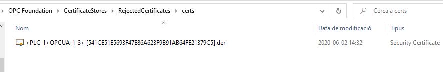

02 Jun 2020 08:00 #8540 by support
In picture for Step 3, you show that the certificates you trust have thumbprints that start with 541C... and 52B9...
In picture for Step 4, the certificate that came from the server has a thumbprint that starts with 5F9A... This certificate is not among the trusted certificates.

02 Jun 2020 06:49 #8539 by Ureña
Replied by Ureña on topic Certificate Failure in windows services
I attach some snapshots of the process.
In snapshot 1 you can see the folders tree I have inside OPC fundation
First of all, I removed all the OPC Foundation folders, then started the application and dont accept the certificate, then I had the certificate in rejectedCertificates(Snap2).
I cut the certificate from the folder and pasted to UA Applications/certs.(Snap3). Then I started again the application(Snap 4) but it tells me to trust again, I accepted the certificate so i had the certificate in UA applications and not in rejectedCertificates. However, if i restart the application it tells me again to accept the certificate and if I say no, it copies again the certificate to RejectedCertificates so i have the same certificate in the both folders.
finally, I attach the last snapshot of the server certificate, maybe with this kind of certificate I have to do something different.
