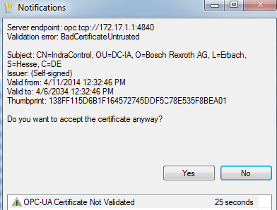

12 Jul 2016 13:24 - 12 Jul 2016 13:27 #4224 by support
Do not use
EasyUAClient.AdaptableParameters = EasyUAAdaptableParameters.OpcCompliance;
unless absolutely necessary. Just stay with the defaults, and if there is a specific need to tweak something, change just one specific parameter. The EasyUAAdaptableParameters.OpcCompliance changes too many things at once, mainly to worse.
I have preliminary result about the ObjectDisposedException. It is a bug on our side which appears when following parameters is set:
EasyUAClient.AdaptableParameters.SessionParameters.CheckEndpointDomain = true;
(and which, in turn, is part of the EasyUAAdaptableParameters.OpcCompliance parameter set).
We will try to have a fix for you during the next week. By that time, removing the usage of EasyUAAdaptableParameters.OpcCompliance, or setting the parameter afterwards as below, is a workaround.
EasyUAClient.AdaptableParameters.SessionParameters.CheckEndpointDomain = false;
Last edit: 12 Jul 2016 13:27 by support.

12 Jul 2016 12:29 #4222 by support
Have you changed the static or instance parameters of EasyUAClient since your last tests?
Can you post a code showing how you initialize these?
In the default state, these parts of code should not even be called, unless you specifically enable them.
Nevertheless, the ObjectDisposedException should not be happening, and I have forwarded it to the programmer for investigation.
12 Jul 2016 07:52 - 12 Jul 2016 08:09 #4221 by Erik
Hello
I finally had time to look into this update and I run into the following issue:
With the following stacktrace
System.ObjectDisposedException: Cannot access a disposed object. Object name: 'AllowEndpointDomainControl'. at System.Windows.Forms.Control.CreateHandle() at System.Windows.Forms.Control.CreateControl(Boolean fIgnoreVisible) at System.Windows.Forms.Control.CreateControl() at System.Windows.Forms.Control.ControlCollection.Add(Control value) at OpcLabs.BaseLib.Forms.ParallelNotifierForm.SetCustomControl(Control customControl) at OpcLabs.BaseLib.Forms.ParallelNotifierForm.ShowSelectedNotification() at OpcLabs.BaseLib.Forms.ParallelNotifierForm.SelectedNotificationChanged() at OpcLabs.BaseLib.Forms.ParallelNotifierForm.notificationListView_SelectedIndexChanged(Object sender, EventArgs e) at System.Windows.Forms.ListView.OnSelectedIndexChanged(EventArgs e) at System.Windows.Forms.ListView.WmReflectNotify(Message& m) at System.Windows.Forms.ListView.WndProc(Message& m) at OpcLabs.BaseLib.Forms.ListViewNoFlicker.WndProc(Message& m) at System.Windows.Forms.Control.ControlNativeWindow.OnMessage(Message& m) at System.Windows.Forms.Control.ControlNativeWindow.WndProc(Message& m) at System.Windows.Forms.NativeWindow.Callback(IntPtr hWnd, Int32 msg, IntPtr wparam, IntPtr lparam)
I have no idea where this is comming from. We have no such object and I never saw annything related to it.
After clicking continue I get a notification window with the following warning:
Waiting 30 seconds I then get:
Clicking yes results in our HMI starting, however, not OPC communication seems to take place. Rr atleast, not a single callback appears to be working (most of our communication is trough callbacks).
