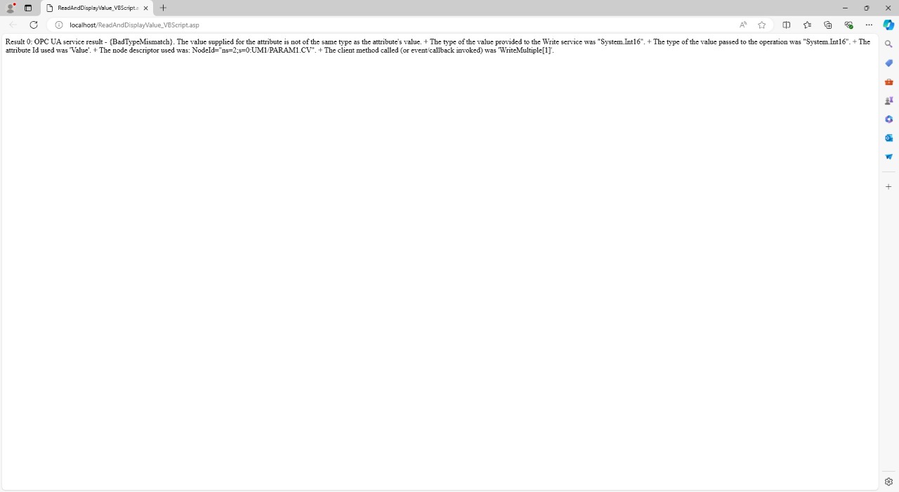

    08 Aug 2024 07:42 #13004 by support
    Everything looks OK on your side, I do not quite understand why the Write does not work. It looks like that QuickOPC has determined the node's value data type as Int16, whereas the server says it is OPC UA Float. Ideally I would like to get to the bottom of it, but for now, please add following line, and retest:
    WriteValueArguments1.ValueTypeCode = 13 ' TypeCode_Single

    07 Aug 2024 18:12 #13000 by support
    What you are doing looks good in principle - although in some cases, there is a necessity to explicitly define the data type for writing. We need to figure it all out.
    Questions:
    - Are you able to write to the very same node using UaExpert?
    - Can you please send a screenshot of UaExpert when this node is selected in the "Address Space" pane - either the whole UaExpert screen, or the Attributes and References panes at least.
    07 Aug 2024 18:00 #12999 by Kyle.Oshima@caltrol.com
    This post is continuation of earlier post requested to be new topic (see QuickOPC VBScript ASP example script not working, cont. )
    Following QuickOPC COM programming examples, QuickOPC OPC UA object call is returning {BadTypeMismatch} error, and am having difficulty finding how proper datatyping is to be specified.
    From Examples - OPC Unified Architecture - Write and specify data type Example 1 states "...If you are calling from a COM language or tool, use the WriteMultipleValues method instead..." Following Examples - OPC Unified Architecture - Write multiple values as template, re-revised "ReadAndDisplayValue_VBScript.asp" example file (see code below) returns following error message: "Result 0: OPC UA service result - {BadTypeMismatch}. The value supplied for the attribute is not of the same type as the attribute's value. + The type of the value provided to the Write service was "System.Int16". + The type of the value passed to the operation was "System.Int16". + The attribute Id used was 'Value'. + The node descriptor used was: NodeId="ns=2;s=0:UM1/PARAM1.CV". + The client method called (or event/callback invoked) was 'WriteMultiple[1]'." (see screenshot below)
    Please advise.
