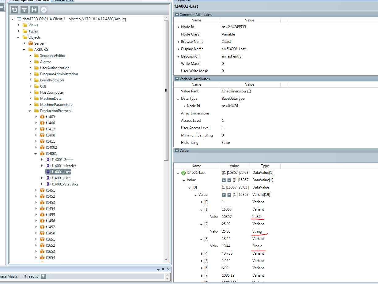

So when I look on the picture of DataFeed client:
EndPointDescriptor is fine.
NodeID: ns=2;i=245533
And I want to get just the second value (15357) and store it as an Integer.
What would be the syntax here, please?

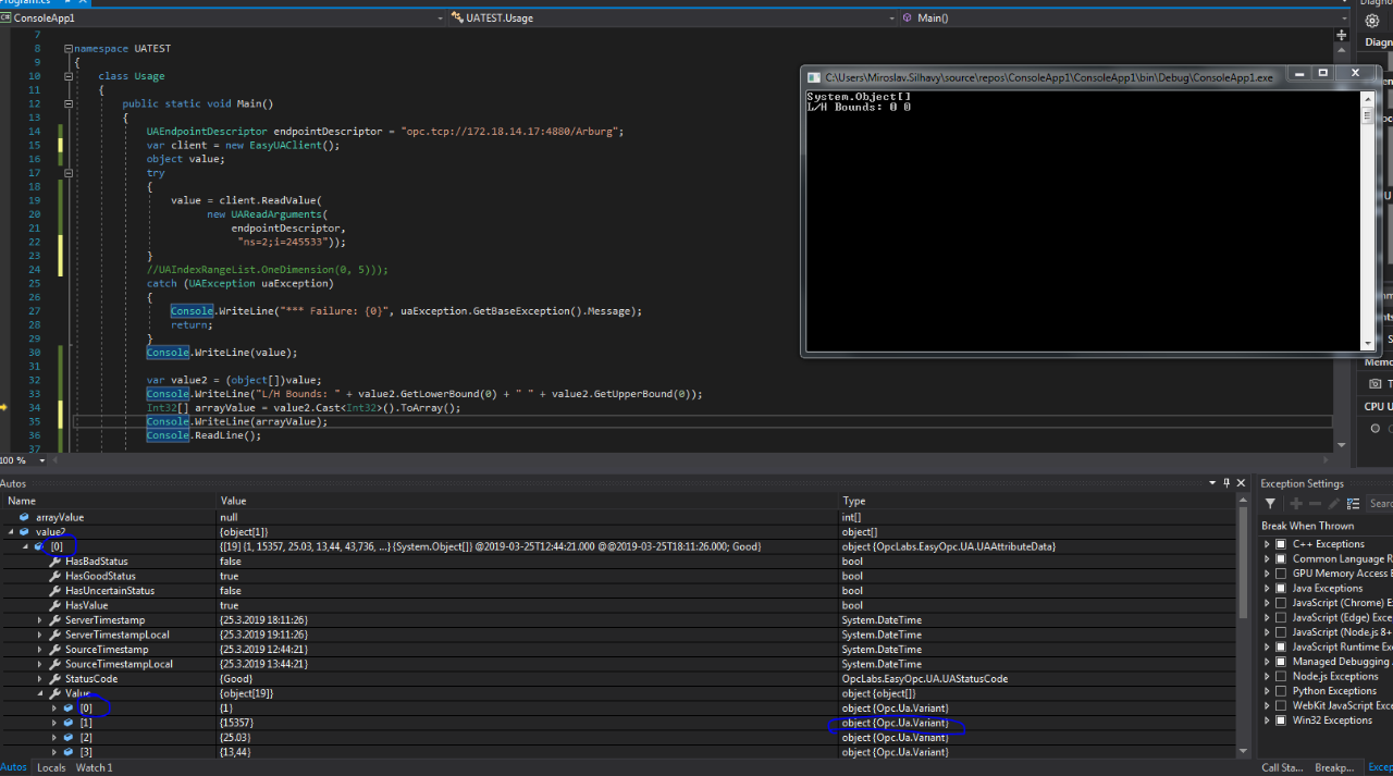

In the array you have received in the first image, you clearly get a value which is an array that has one element, and that one element is then an array that has 19 elements which are values of different types. This is apparent both in the screenshot from DataFEED client (where you have even underlined the types: Int32, String, Single), and it the VS debugger. You are already receiving that from QuickOPC. It's just an issue of processing it correctly in your code. But you need to have an idea of what you want to do. If the array contains values if different types, you cannot cast them all to Int32. I guess that they have different semantics anyway, so you need to know which element means what, know their expected types, and cast them separately. In addition, they come as Opc.Ua.Variant, which is a structure where the actual value is further below. Expanding that in the debugger will nicely show you which member you need to get.

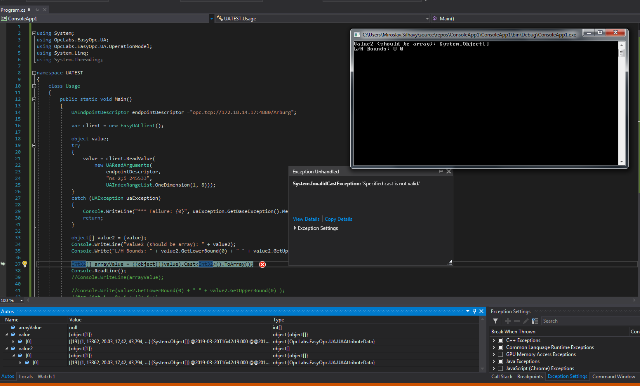

I have made corrections, but still invalid cast:
I have tried server simulator from OPCFoundation, where different types of arrays are present and no problem with anything. I think there is a problem with the node itself (or the datatype) but I cannot find it.

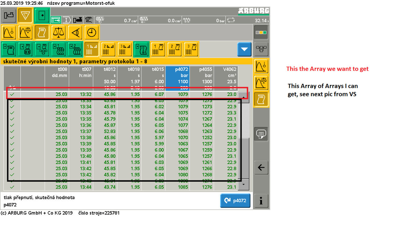

I do not know if you know the Arburg injection machines... there is a production protocol, it looks like this (on the machine display):
And when I want the list of all values (each line, each shot, machine can hold 99 lines so the Ubound 98 is right):

    The line
    object[] value2 = {value};
    makes no sense. You are creating an array with single element which again is the array you have received. No wonder that than the bounds are 0 and 0 (there is a single element), and that the element (which is then an array itself) cannot be cast to Int32.
    I think you should change that line to
    var value2 = (object[])value;
    Having that, you can then simplify the following line:
    Int32[] arrayValue = value2.Cast<Int32>().ToArray();
