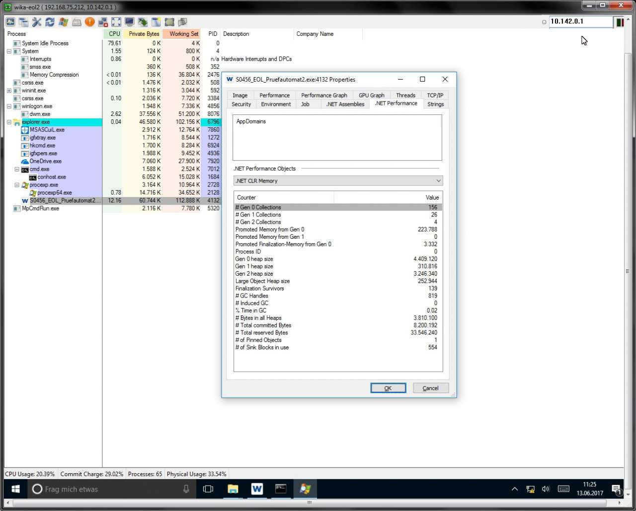

Can you please first check whether these CPU peaks correlate with .NET garbage collections, using PerfMon? See e.g. blogs.msdn.microsoft.com/maoni/2004/06/03/gc-performance-counters/ , counters like
  • “% Time in GC”
  • “# Gen 0 Collections”
  • “# Gen 1 Collections”
  • “# Gen 2 Collections”
12 Jun 2017 06:35 #5228 by RH
High CPU usage peaks was created by RH
we are using QuickOPC in COM from Delphi with subscriptions and about 100 variables. Recently we observed that we get high peaks of the CPU usage for about 2-5 seconds every few minutes. This even causes the main thread of our software to hang and cause problems when performing rather time-critical actions.
With process explorer, we tracked the CPU usage per thread and it seems to be one QuickOPC .NET thread. I actually don't know why it has such a big influence on the main thread. Could this be caused by some synchronizing mechanism in .NET? From Delphi I know that using the command Synchronize from threads causes all threads to synchronize, even those which are not involved. This can leed to bad performance depending on the code running synchronized.
Any suggestions, what we can do to minimize that behaviour?
