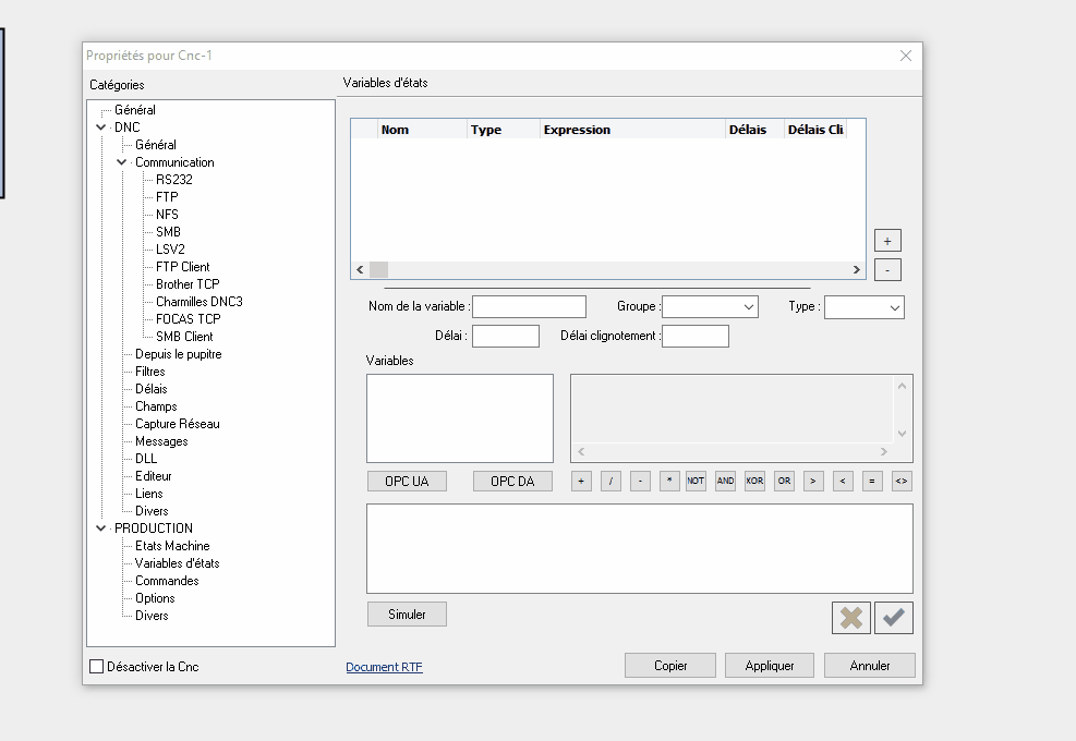

We're having trouble connecting to MOXA's Active OPC UA Server from QuickOPC UA COM generic dialog.
Here is a gif of an attempt to connect with QuickOPC
Here is a link to download the server in case you want to run a test : here
MOXA is configured to use "None" as security policy and "admin" and "moxa" as authentication credentials.
