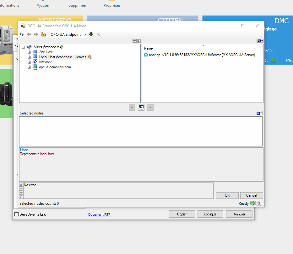

Just so you know, it's not just about being able to see the properties on the right hand side of the form.
What we think introduce confusion is that when you select a tag node and click the button to add it to the "selected nodes" field, it also automatically add all it's property.
As you can see in the UA gif, when Int16Value is selected, EURange is automatically added to the "selection nodes" section.

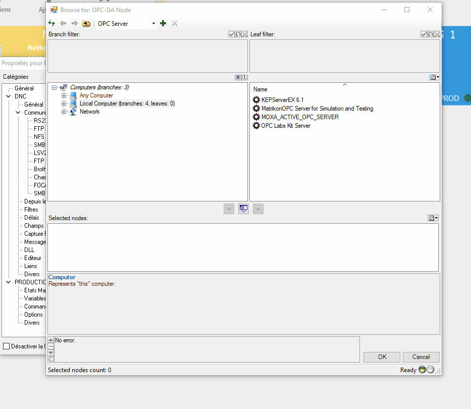

BrowseDialog := TUABrowseDialog.Create(nil); BrowseDialog.Mode.SelectElementType := UAElementType_Node; //BrowseDialog.Mode.SelectableNodeClasses := UANodeClass_Variable; BrowseDialog.Mode.MultiSelect := true; BrowseDialog.ShowDialog(nil);
you can find attached a gif of the result in OPC UA and DA.
in DA we don't see the attributes.
in UA we see them.
