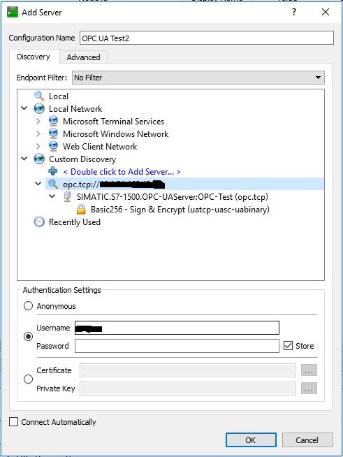

Thank you for the information. I do not see anything with your code now, and I also understand that UaExpert shows the Sign&Encrypt endpoint - but the error message on our side seems to indicate that the only endpoint returned to us was with security None.

In the Image you can see how UaExpert shows the endpoint. It seems that the config server is ok.

I do quite believe that the very same works from the UaExpert. Are you connecting to precisely the same endpoint? When you use UaExprt, does it actually SHOW you the secure endpoint and allow you to select between these different endpoint configurations, or do you have to explicitly tell it the parameters of the endpoint?
