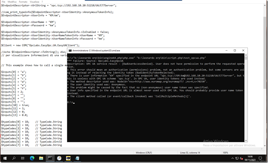

Please create a new topic thread next time, for any new issue. You can always put inside a link to some other post, if there is a relationship. In this case, you have added to a forum thread that is not actually related, making the forums look more confusing to the user.
I know where your problem comes from.
First, you can remove the parts of your code that set the UserInfo, UserName and/or Password on the $EndpointDescriptor directly. The correct part is the one with $EndpointDescriptor->UserIdentity.
Then, the actual problem lies in the usage of the CallMethod method, and the $EndpointDescriptor->ToString() as its first argument. What happens there is that $EndpointDescriptor->ToString() does not represent all contents of the endpoint descriptor - so by converting it to string, the user identity gets lost.
But if course you HAVE to use a string for the endpoint descriptor with the CallMethod call in COM (PHP). This is because COM does not have method overloads. In .NET we have an overload that has the actual UAEndpointDescriptor object as the first argument - as well as many other overloads. In COM we have chosen the most simplest case as the overload to expose.
We still allow the operation to made in COM as well - but you need to switch from the simplest method (which is CallMethod) to the other method that is the "most complicated" one: In this case, CallMultipleMethods.
So, even though you are calling just one method, in COM (PHP) you need to rewrite your code to use CallMultipleMethods, with one method. The CallMultipleMethods accept an array of arguments, each describing one method call. The array element then contains the full UAEndpointDescriptor object, so you can fill it in correctly, including its UserIdentity.
Unfortunately we do not have the PHP example with CallMultipleMethods currently available, but you should be available to construct it using that example in other programming languages, here: opclabs.doc-that.com/files/onlinedocs/QuickOpc/Latest/User%2...Call%20multiple%20methods.html .
I hope this helps.

Up to now we have profitably used your library to implement numerous integrations between our management software and customers' machine tools.
We have never needed to activate the connection with user/password but now we find ourselves in the situation of needing it to be able to use the CALL function of a method that is inhibited for anonymous connection (in the below example you’ll find all the authenticated access modes we tested, even individually).
Let's start by saying that, on this same machine, we are already collecting data from an anonymous connection.
Below we attach the used code and runtime screenshots showing reported errors.
Can you give us some suggestions to unravel the problem?
PHP SOURCE CODE
