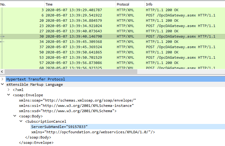

The attached screenshot is a result of "GetStatus" call

    08 May 2020 16:35 #8474 by Andriy
    While investigating a communication between my application and Siemens OPC XML-DA Gateway server, I found a lot of subscription cancellation requests. They happen immediately after receiving a response to the subscribe request . The response of the OPC server is very slow. I don't know what is wrong. Could you help me?
    QuickOPC 5.58.151
    Isolated = true
    IsolatedParameters.UseAdvancedPolledRefresh = false
    1. Subscribe request
    2. Subscribe response
    3. Next 2 telegrams are related to "GetStatus" call
    4. Subscription cancel request
