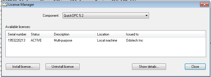

19 Oct 2017 19:14 #5598 by dchuet@odotech.com
OK, sorry, since I had to re-install QuickOPC, the license I installed previously was removed....
I re-installed the license, but now I have the error code -2147221230 when I read tags
We will soon recompile our platform to support error messages display but in the meantime if you could tell me what is error code -2147221230 it would be very useful.

19 Oct 2017 18:03 #5597 by support
The actual error code is -1073419774 as it was in your original email (the minus sign is significant). It corresponds to 0xC004EA02.
We do not provide a list of error codes. There is an error message and more details that come with each error. The code could you the Exception property, to provide that information. Had it done that, the error message would be:
Not allowed to run by the license. You might be using a trial license, and the version of the software you are using is obsolete. Obtain a recent version to resolve this problem.
I need a picture of the License Manager screen with the license installed. You can post it here, or send by email.
