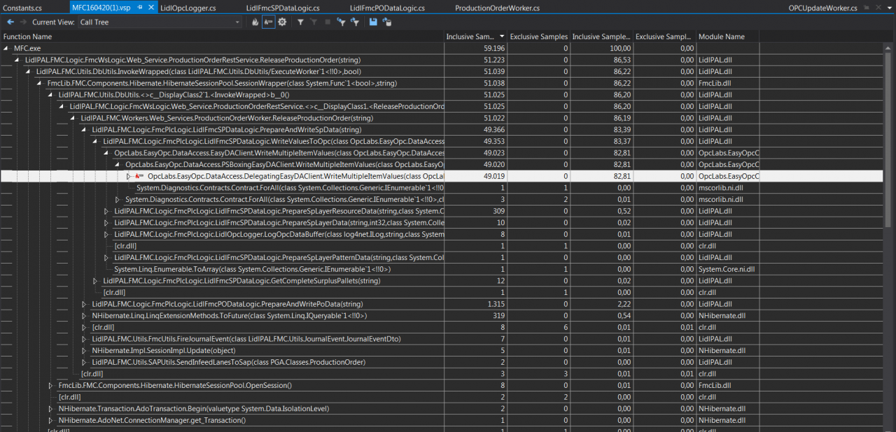

26 Apr 2016 17:04 #4017 by bojan
Hello QuickLabs,
A) What is your benchmark time and in what scenario for sending 56 thousand records to your client?
Here are answers to some of your questions:
1. What QuickOPC version and build you are using? (tip: Start the installation program you have used, and take these form the first page of the wizard; then abort the installation).
QuickOPC 5.35
2. Which OPC server are you using?
INAT OPC Server
3. Is it located on the same as the client application, or remotely?
It will be remotely but we are testing with server on the same computer as client.
4. How long does it take before the WriteXXXX methods returns, when used with 700 thousand items?
We use WriteMultipleItemValues, for 138 items we need ~ 13 seconds and for 505 items ~ 16 seconds
5. How long does it take before the WriteXXXX methods returns, when used with 40.000 thousand items?
For ~ 16000 we need 48 seconds
