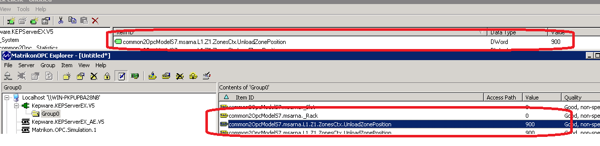

03 Mar 2015 21:43 - 03 Mar 2015 22:07 #2892 by miron
Replied by miron on topic Problem with reading and writing
Let's concentrate on one case. writing to TCP for Simens
In picture you could see two connection to Kepware OPC Serwer
from two differenct OPC Client.
(It is driver TCP for Simens)
When I change value in one I could see change in second.
But when I execute code to write this value in Quick OPC
I could not see changes.
I executed test in both cases: for isolated=false and isolated=true
Results was:
Test for: /common2OpcModelS7/msarna/L1/Z1/ZonesCtx/LoadZonePosition
isolated: False
value: 100
ValueAfterRead=100 {System.Int64} @2015-03-03 21:31:49; Good GoodNonspecific LimitOk (192)
isolated: True
value: 100
ValueAfterRead=0 {System.Int64} @2015-03-03 21:31:50; Good GoodNonspecific LimitOk (192)
This two tests did not modify value in opc server.
Isolated = false looks like read from cache because value in opc server had different value.
Was not set.
Main question:
Why it works for two different OPC client (instances and vendor) but not for QuickOPC?
My test:
void Main() { Test.TestReadWrite("/common2OpcModelS7/msarna/L1/Z1/ZonesCtx", "LoadZonePosition", (uint)100,false); Test.TestReadWrite("/common2OpcModelS7/msarna/L1/Z1/ZonesCtx", "LoadZonePosition", (uint)100,true); } class Test { public const string cServer = "Kepware.KEPServerEX.V5"; public static void TestReadWrite(string rootPath, string valName, object value, bool isolated) { string path = rootPath + "/" + valName; Console.WriteLine("--------------------------------------------------------------------------"); Console.WriteLine("Test for: " + path); Console.WriteLine("isolated: " + isolated.ToString()); Console.WriteLine("value: " + value.ToString()); EasyDAClient c1 = new EasyDAClient(); EasyDAClient c2 = new EasyDAClient(); c1.Isolated = isolated; c2.Isolated = isolated; c1.WriteItemValue(new ServerDescriptor (){ ServerClass = cServer}, new DAItemDescriptor() { BrowsePath= path},value); Thread.Sleep(1000); var ds = new DAItemDescriptor() { BrowsePath= path}; if (value is bool) ds.RequestedDataType = VarType.Bool; var valB = c2.ReadItem( new ServerDescriptor (){ ServerClass = cServer}, ds , new DAReadParameters(){ DataSource= DADataSource.Device, } ); Console.WriteLine("ValueAfterRead=" + valB.ToString()); } }
Last edit: 03 Mar 2015 22:07 by miron.
