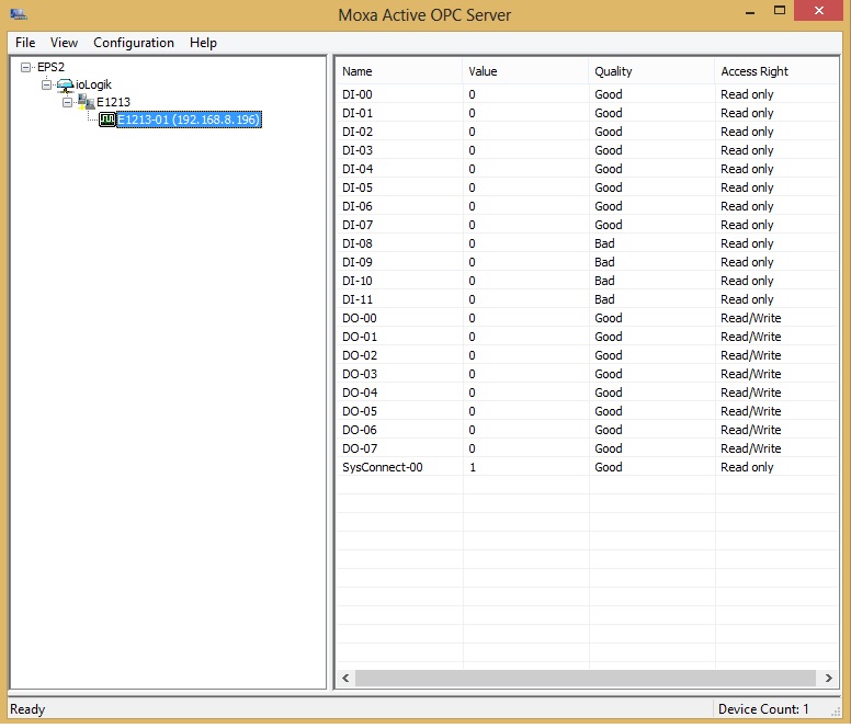

There may be a way to do it, if the target OPC server has provided a capability for it. For example, it can have the IP address "encoded" in the node name (as in the picture taken on the server side); but if I understand it correctly, the part in parentheses does not appear over the OPC browsing, right? Or, the server could provide this information in form of a vendor-specific OPC property on the PLC branch; to check that, call EasyDAClient.BrowseProperties. In general, because this question is server-specific, it should be answered by consulting the server's documentation, or by the producer of the server.

P.S. In the Moxa Active OPC Server in the tree view, the device is under ioLogik listed as E1213-01(192.168.8.196)
