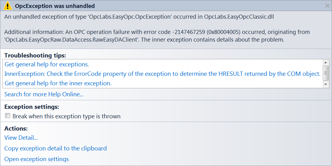

As far as I can tell, the behavior is as designed/intended.
The error your are getting has its origin in the server, which rejects the "Write" operation. QuickOPC informs you about the problem by throwing the exception. The inner exception says it is a COMException; it does not have a particularly helpful error code or message ("Unspecified error", which corresponds to E_FAIL), but that is because the OPC server decided to return this error code.
The exception (of OpcException type) is unhandled, because your code does not handle it. Throwing the exception is our intent here - you can decide what to do about it (ignore, report to the user, etc.). Note that you may get exceptions for many other reasons as well (server down, ...), so do not think just in terms of exceeding string lengths etc. You can read about the error handling in the documentation. Basically you should wrap calls like WriteItemValue in a try/catch block, and catch OpcException.

In theory the error may also come from some other call (not directly from the target OPC Server), but that's unlikely. If you want to verify this, just use e.g. the Softing demo client, execute the same test, and observe the errors in the Errors tab.

2) As I was testing, I believe that I may have discovered another error with Quick OPC. In my micro850 PLC, I have a string of length 20 defined. When I write a string that is more than 20 characters via Quick OPC to Kepserver, Quick OPC throws an unhandled error. See attached screen shot and error detail. Naturally, from my end, I will make sure that I do not write a string longer than 20 characters, but in many cases I will not know what the maximum length will be. Let me know if you require more information. Also, please advise as to next steps and if any improvements will be made to Quick OPC.
