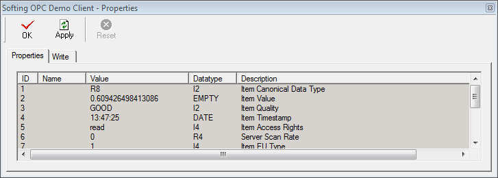

Just to make it clear, the "Properties" window from Softing demo client (lower left corner of your picture) are *not* the OPC properties on the item. They are various pieces of info assembled together when the Softing client is reading or subscribing, and it's all available only *after* you "add" an item to the group (i.e. not really what you want to do).
If you wanted to see the true list of OPC properties on a given item using the Softing OPC demo client, you need to
  1. Switch to the "DA Browse" tab (at the bottom of the window)
  2. Navigate to an item and right-click on it
  3. Select Properties (F7).
You may then get something like this:

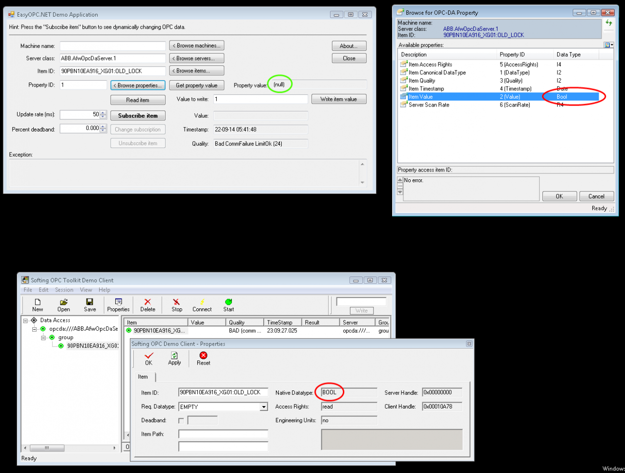

22 Sep 2014 05:54 #2325 by johannduplessis
Thanks for the answer! Yes part of the problem is that the OPC server is not working correctly as it's not connected to the plant network.
I'm attaching a screenshot displaying the problem:
At the top is the OPCLabs Demo Application showing the item that I'm trying to get the data type for. As you can see, when calling the normal GetPropertyValue method it returns null (in the green oval). However, when calling BrowseProperties it shows the correct data type (boolean in this case). This matches up to the data type returned by Softing's OPC client (shown at the bottom).
Fortunately, after running a test app through the night it seems that BrowseProperties is very efficient. I'm not sure why, but if I call it for every tag it returns the properties VERY quickly. I still have to test it with the whole dataset though.
If that doesn't work I'll try your sneaky idea, it sounds like it just may work.
Thanks!

I'm in the process of writing an OPC client in C#2012 to download the entire namespace of an OPC server. However, in our test setup the OPC server is not connected to the actual plant, so the quality of all the tags are bad. It is possible to navigate through the structure using any OPC client and see the data type of the values (boo/string/etc). This is where my problem comes in:
- When using BrowseProperties I can retrieve this type (by looking at the DataType of the Value property).
- When using GetPropertyValue and specifying DAPropertyId.DataType (and GetMultiplePropertyValues, which is the function I actually want to use), I can't retrieve the type. The value returned is null and the DataType property in this case is null as well.
My question is, how can I retrieve the property type using GetMultiplePropertyValues in this case? BrowseProperties is much too slow as I need to retrieve the DataType of approximately 2.5million tags.
