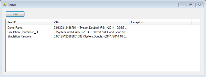

01 Aug 2014 12:12 - 01 Aug 2014 12:24 #2123 by support
I have prepared an example in VB.NET which reads OPC data and populates the ListView.
There are three items pre-populated in the ListView, with their Item IDs. Each item also has sub-items, for the VTQ (value-quality-timestamp), and a possible exception (error indication).
When the Read button is pressed, the code takes the OPC item IDs from the list view, assembles an array of arguments which allows all items be read in a single operation (for good performance), and then calls EasyDAClient.ReadMultipleItems. The resulting array is then used to update the sub-items in the list view.
The relevant pieces of code are here:
Private Sub ReadButton_Click(sender As Object, e As EventArgs) Handles ReadButton.Click Dim count As Integer = ItemsListView.Items.Count Dim argumentsArray(count - 1) As DAReadItemArguments For i = 0 To count - 1 Dim listViewItem As ListViewItem = ItemsListView.Items(i) Dim itemId As String = listViewItem.Text argumentsArray(i) = New DAReadItemArguments("OPCLabs.KitServer.2", itemId, 50) Next Dim resultsArray() As DAVtqResult = EasyDAClient1.ReadMultipleItems(argumentsArray) For i = 0 To count - 1 Dim listViewItem As ListViewItem = ItemsListView.Items(i) Dim vtqResult As DAVtqResult = resultsArray(i) Dim vtqText As String = "" Dim exceptionText As String = "" If (vtqResult.Exception Is Nothing) Then vtqText = vtqResult.Vtq.ToString() Else exceptionText = vtqResult.Exception.Message End If listViewItem.SubItems(1).Text = vtqText listViewItem.SubItems(2).Text = exceptionText Next End Sub
The project (zipped) is attached.
File Name: ListView1.zip
File Size:15 KB
We probably have to do this iteratively: If this is not quite what you wanted and does not give you enough to start on your own, let me know which parts are missing, and I will provide further examples or guidance.
One thing that may not be addressed in this version: You mentioned that you want it to operate “asynchronously”.
There are at least two possible interpretations:
1. You want that OPC methods for asynchronous reading/writing are used, between the OPC client and the OPC server. This is already taken care: We use asynchronous methods whenever possible, by default (can be changed by a parameters passed to EasyDAClient).
2. You want the OPC operation appears asynchronous to your application – e.g. the Read would be performed while the user interface stays responsive, and the list view is updates upon the arrival of the data. Currently we do not give you API to do this (besides subscriptions which is a bit of different story), but it can be done using a separate thread. Is this what you wanted?
