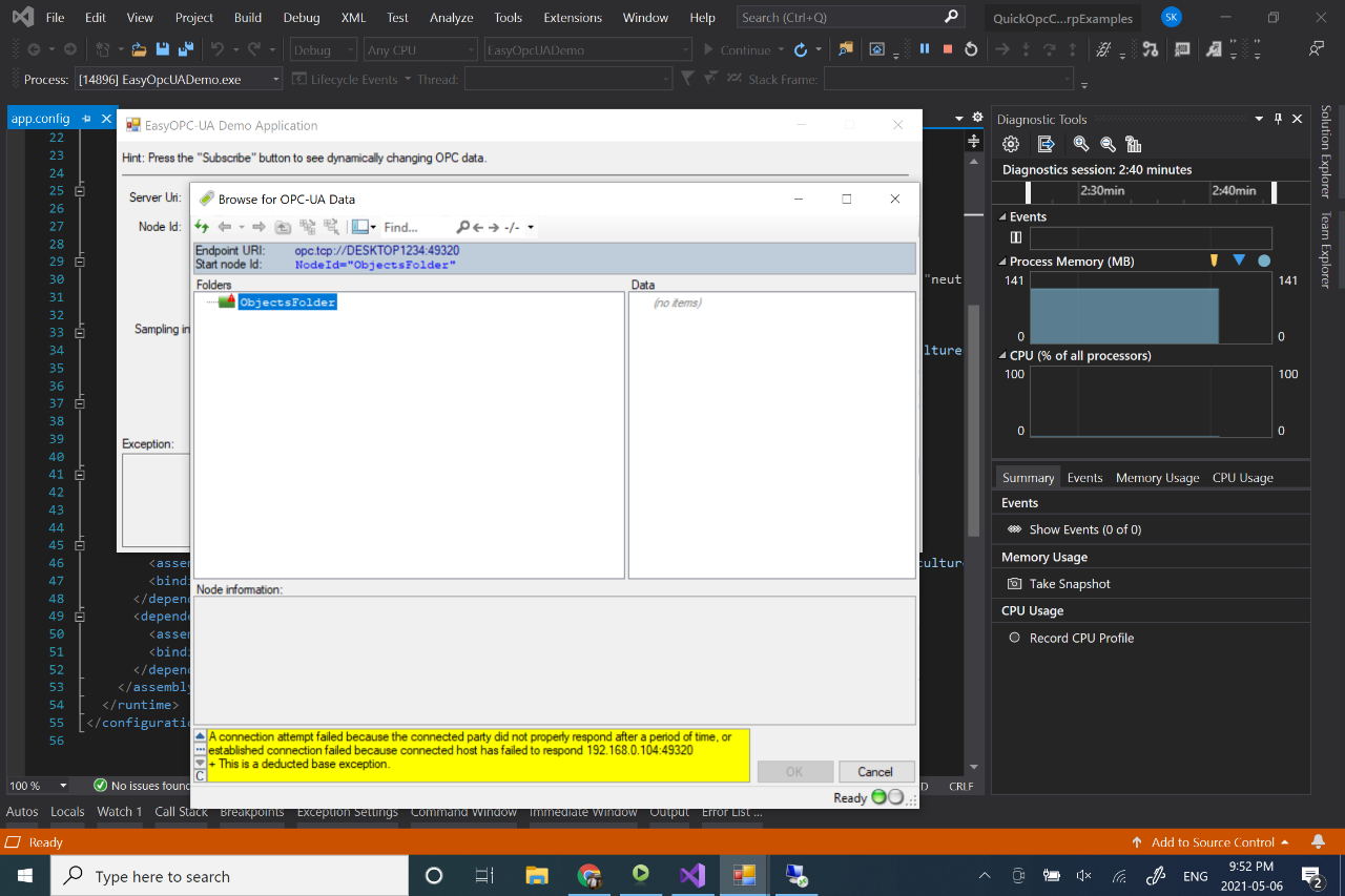

07 May 2021 10:05 #9652 by aksenthil
Thanks for your reply.
The screenshot I shared with you for the information to show which application I am using.
I am using kepware server in a remote machine. I created an inbound rule and an outbound rule for the 49320 port.
The firewall is running.
In the kepware server, It was requesting a client certificate to trust the client.
Please guide me further on how to proceed to establish a connection between the easy OPC UA Client to connect with the kepware OPC UA Server at the remote machine.
Right now, I am using easyUAOPCDemo ( C# examples Visual studio) for the OPC UA Client from the OPC Labs
with regards,
senthil
07 May 2021 04:55 #9651 by support
I do not understand this part of your report: "The actual reason I was not able to generate Certification for my client.".
There is nothing in the error messages that would indicate a relation to a certificate problem.
The error message means that failure happens when a TCP connection is being established to the target server. And there is no response. Usually this means a mistaken address, or that the server is not running, or is not configured to listen on the specified port, or there is a firewall in between that blocks the connection.
06 May 2021 16:30 #9648 by aksenthil
Dear Team,
I am using OPC UA client 2021.1 ( 5.60.107)
On the remote machine, I had Kepware UA Server.
when I try to connect from My Desktop, I am getting the error 'remote server not responding."
Please guide me on how to create a certificate for my application and connect with Kepware OPC Server.
Is there any step-by-step document is there to communicate. Please let me know and share the same to establish Communication.
I attached the error for your observation
with regards,
senthil
