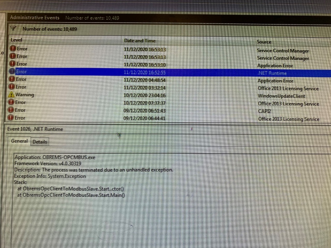

11 Dec 2020 17:18 #9261 by support
Replied by support on topic Service starting Error 1053
You have two problems:
1. The fact that the "license expired" exception is thrown. This is not our exception, and does not refer to our (QuickOPC) license. Probably the other product you are using.
2. And, when this exception is thrown, your code does not handle it well.
11 Dec 2020 16:22 #9259 by Hicham21
The debugging gave the attached error "Licence expired " , but if look at picture from below it seems the licence is infinite.

    I checked the windows event log and found the following error.
