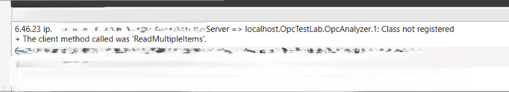

Regarding the "Class not registered", I believe you must be doing something wrong - it is already suspicious that the error message says "localhost.OpcTestLab.OpcAnalyzer.1", because the correct ProgId does not have the "localhost." in it.

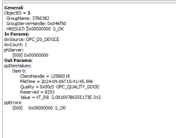

I received the OPC Analyzer trace files and other material via email. Unfortunately, the one that seems to contain the "good" trace, i.e. the file AbbRTDBOpcServerReadFromOpcExpertClipboardCopy.tra , is somehow corrupted. I cannot open it in the OPC Analyzer. Can you please re-do this, and check the OPC Analyzer can actually open this file (File -> Open Trace)?
Nevertheless, it looks like that you have already properly noticed that the weird double value *is* actually being returned to us - because the OPC Analyzer has captured it and displayed in the same way:

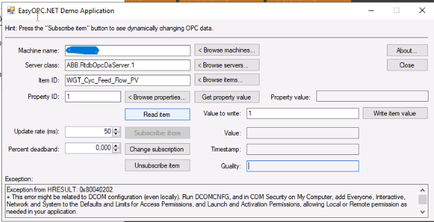

    #1 The subscription mode is supported by the server, external opc client like opc-expert is able to read the tag data which is updated every second and values are decoded properly. however opc labs is throwing DCOM permission exception.
    And the demo tool does not fetch any values afterwards. I have to close and re-open application.
    #2 I tried to write data through old version of opc labs and opc-expert tool but both of them gave errors for class not registered. I did try to register the exe with RegServer command but the EasyOPCDemo tool was not throwing any error and it was able to write it.

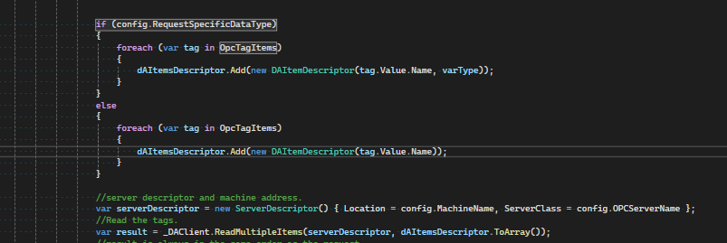

    3. It seems a COMException because I received the errorMessage string inside DAVTqResult[] after making the ReadManyRequest Call.
    4. You are right in understanding that my code is passing the Unknown DataType. it was a minor oversight which caused the confusion. the flag was turned on in the system without supplying a data-type, which led default selection of Unkown to be selected.

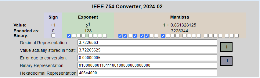

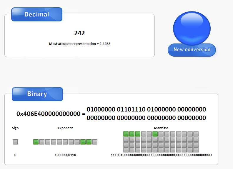

    See from the below screenshot 1 i tried to convert 242 decimal to binary, I used the following online converter,
    www.binaryconvert.com/result_double.html?decimal=050052050
    Then I took the hex value and fed into another online IEEE754 Floating point converter,
    www.h-schmidt.net/FloatConverter/IEEE754.html
    In the SDK's data type detection, it appears that the expected value of 242 is not being returned. The other third-party application decodes the value correctly, so I strongly suspect that OPC Labs may be mishandling the conversion of values to float or double. The actual data type is double, but it seems that OPC Labs is converting it to a float and then returning that value as a double.
    the real-time value is a bit off by couple digits but we can ignore that since the actual value that we received could be a different. And I am also aware that tags are a bit different.

    3. Due to the "unknown" message text (#2 above), we cannot determine the actual error code. Can you please provide us with a) the type of exception object you are getting (is it COMException?), and b) the ErrorCode property of the exception (an integer).
    4. You wrote that "…the library is detecting the data type as "Unknown, …". I do not fully understand this statement. From the error message, it can be seen that "Unknown" is the requested data type, i.e. something your code passes into our method (ReadXXXX), and it is not something that "the library is detecting". In the default setting, what the code passes in is the data type "Empty", which causes the server to return the value in the item's canonical data type. So I believe it is actually your code that passes in the "Unknown" data type. It is possible that, preceding the ReadXXXX call, you somehow obtain the data type, receive "Unknown", and then pass it to the ReadXXXX method. But if so, I will need more details about it - why are you doing it, and how precisely are you doing it (how are you obtaining the data type). Or, if you think your *not* doing it, please post here the relevant pieces of code that assembles the arguments for the ReadXXXX method and calls it, because I believe there must be something that sets the data type to "Unknown".

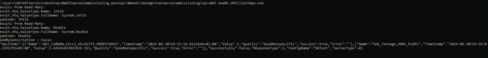

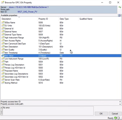

    I hope this message finds you well. My name is Harsh, and I am part of the software development team at Woodgrove Technologies. We have been utilizing your OPC Labs Classic (OPC-DA) and OPC UA components in our software, which is built on the .NET Framework 4.7. We purchased a permanent license with five years of support in December 2022, and I am pleased to inform you that your components have proven to be highly stable and integral to our software for many years.
    However, we have encountered an issue during a recent deployment. When connecting our application to the ABB.RtdbOpcDaServer.1 OPC server, we observed that the library is detecting the data type as "Unknown," as illustrated in the attached Image 1.
    Image 1: Woodgrove's test opc client built with OpcLabs.QuickOpc.5.80.347

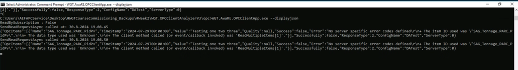

    The original values, as seen in the OPC server and validated by other clients, are shown in Images 3 and 4:
    Image 3: OPC Expert's result from the same DA server
    Image 4: Woodgrove's opc client built with OpcLabs.QuickOpc.5.59.1034

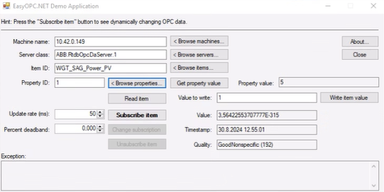

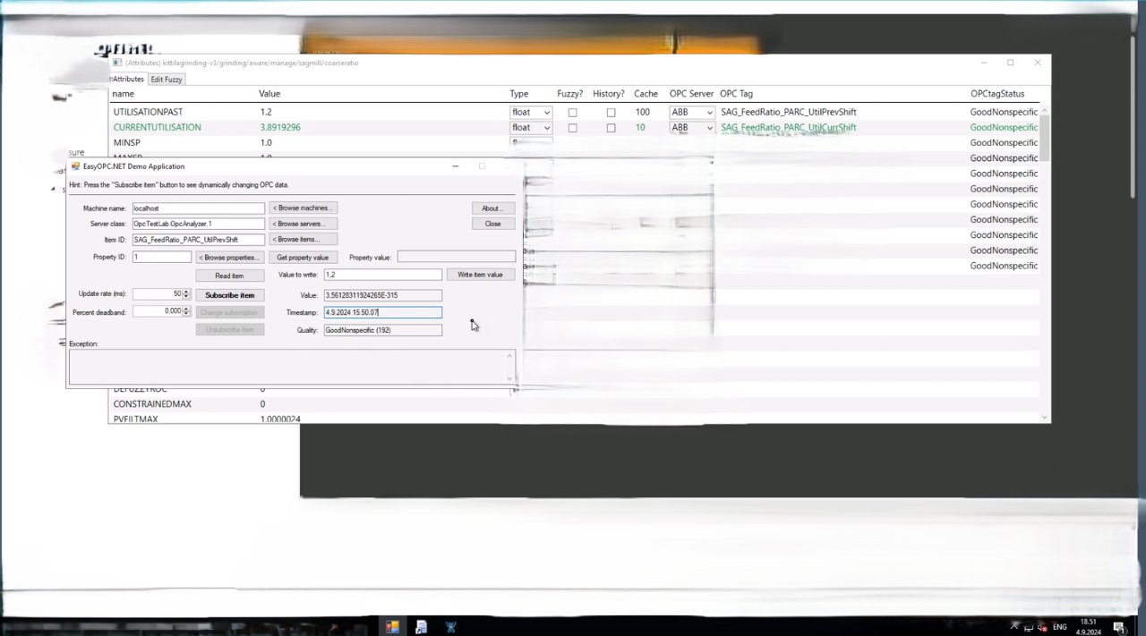

    Additionally, using the demo application included with the OPC Labs QuickOPC 2022.2 Installer resulted in a similar issue as shown in Image 2:
    Image 5: OPC Labs EasyOPC.NET Demo application
