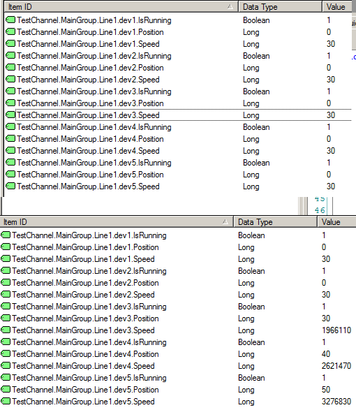

Thank you for your quick answer.
I have made mistake with addressing simulation tag.
Variables are type of 'long' but address which I put overlapped addresses.
And one write was interfered to another. I am sorry.
Linq Pad is very useful to quick scrat code. File Linq beside C# code, also contains
reference to assembly and declaration of namespaces.
To execute code it is not necessary build code.
Last edit: 15 Feb 2015 22:26 by miron.

Question 1. I have question about best practice in mapping collection by live mapping.
I have made simple example in linq pad.
Generally: I have one class Line which could contain several object of type Device.
public class Line { public List<Device> Devices {get;set;} }
In my example I have created mapping for each object of Device. Maybe there is another good way to do this.
I also could observed strange behavior. It looked that some values was not initialized correct value after
execution procedure.See screens.
When I crate simple loop in the end of program I have seen some randomize values.
for(int x = 0; i < 20; i++)
mapper.Write();
Thread.Sleep(2000);
Question 2:
Maybe several object of the same type should be mapped by separate instance?
C# example which could be run in LiqPad:
[DAType] public class Device { public string DeviceCode {get;set;} [DANode()] [DAItem()] public bool IsRunning {get;set;} [DANode()] [DAItem()] public int Speed {get;set;} [DANode()] [DAItem()] public int Position {get;set;} } public class LineDef { public LineDef() { Devices = new List<Device>(); } public List<Device> Devices {get;set;} } void Main() { var sd = "Kepware.KEPServerEX.V5"; //initialization object var line = new LineDef(); line.Devices.Add(new Device() { DeviceCode="dev1"}); line.Devices.Add(new Device() { DeviceCode="dev2"}); line.Devices.Add(new Device() { DeviceCode="dev3"}); line.Devices.Add(new Device() { DeviceCode="dev4"}); line.Devices.Add(new Device() { DeviceCode="dev5"}); //preparing mapping var mapper = new DAClientMapper(); foreach(var dev in line.Devices) { mapper.Map(dev, new DAMappingContext { ServerDescriptor = sd, // local OPC server NodeDescriptor = new DANodeDescriptor { BrowsePath = "/TestChannel/MainGroup/Line1/" + dev.DeviceCode}, GroupParameters = 1000, }); } mapper.Read(); var i = 1; foreach(var dev in line.Devices) { dev.IsRunning = true; dev.Position = 10 * i; dev.Speed = 30; i++; } mapper.Write(); }
I have attached:
  1. C# example - which could be run directly in linq pad ( www.linqpad.net/ ) (changed extension to txt)
  2. Picutre with not correct values from opc client
  3. csv definition exported from OPCKeepServer (changed extension to txt)
Last edit: 15 Feb 2015 17:01 by miron.
