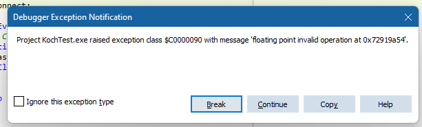

27 Sep 2023 15:58 #12245 by ColinOPC
Hi ,I have built a very small application that has the same issue, I have attached all the Delphi code and the compiled Debug version of our app, also some more event information for you.
File Name: KochOPC.zip
File Size:14,204 KB
While my main project on the same machine compiles and runs under release and debug, this small application, fails under both release and full debug mode, and always in the same call to your connect procedure. Not sure if the debug dump is useful but this is everything i have currently.
Very strange why it indicates a floating point invalid operation in full debug mode, i guess it must capture this on the exception thrown by your .NETT code.
Whats most strange is this small app crashes on the Delphi machine where as the full 14,000 lines application is fine, or at least returns from your connect procedure, thanks again for the assistance.
Colin
