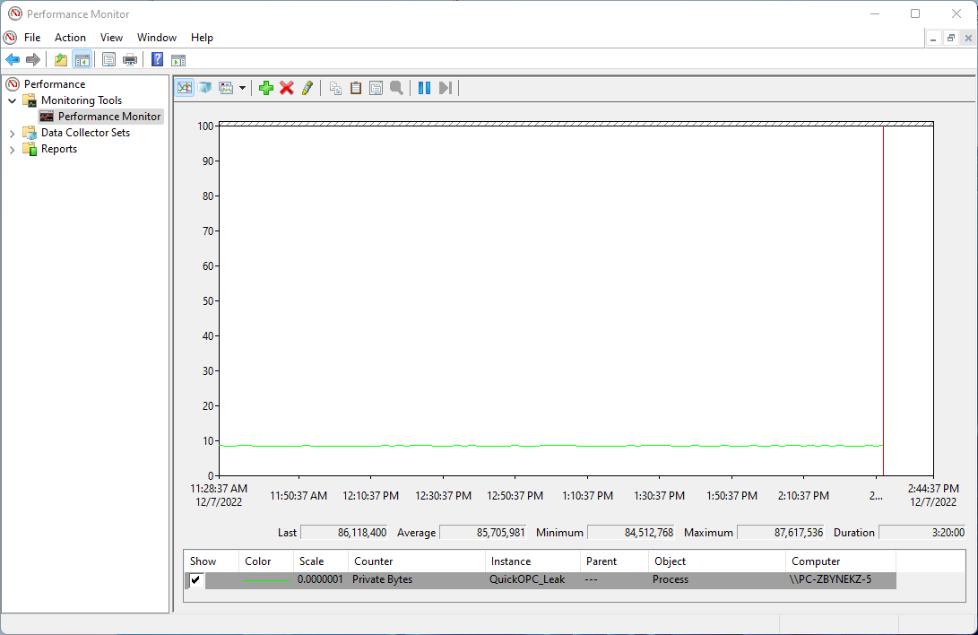

    I attempted to reproduce the issue, but have not succeeded. This was done with Release x64 build, outside of Visual Studio, with no OPC connection interruptions.
    Here is the result of my test run, over the course of 3 hours. It shows no signs of memory leak.
    For record, there were following differences (known to me) from your test:
    1. I updated the referenced version of QuickOPC package to the recent one (2022.2) available as of today. In the process, I changed the format of references from "packages.config" to the new "Package Reference".
    2. Switched the project to target .NET Framework 4.7.2, as it is the new minimum required by the current version.
    3. Replaced the initialization of ServerDescriptor by a single call to "new ServerDescriptor("...")", because the particular overload of ServerElement you wer eusing is no longer present in the current version, and it was unnecessary to use ServerElement there.
    4. Added some diagnostics output (Console.WriteLine) to better indicate operation failures, and count the number of EasyDAClient objects in use at any particular moment.
    I do not think that differences #2, 3, or 4 have any significance. Difference #1 may be the cause; we have not specifically fixed any memory leak between your version and ours, but there were lots of changes everywhere, so it is always a possibility that it is gone now. Another explanation is that there is some other difference that I do not know about.
    Either way, until I have a reproducible scenario, there is nothing else I can do.
