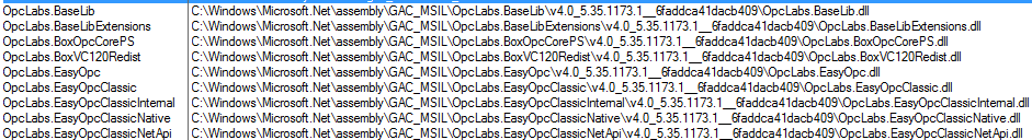

The application in question is written in c# and utilises QuickOPC. I have attached the OPC dll references.

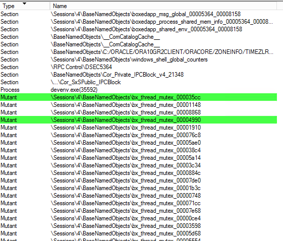

Sample Mutant handle creation from Process Explorer

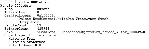

Sample abandoned Mutex information from WinDbg
