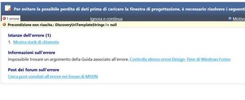

19 Oct 2018 07:00 #6761 by support
Replied by support on topic QuickOPC 5.23
Hello. Thank you for the details. I know I have told you to post this on the forums. I hoped that it might be an issue for which we have solution, even though it is with an unsupported QuickOPC version (5.23).
Unfortunately I have to disappoint you in this respect.
I can only offer a workaround: It looks like that the issue is related to the so-called VS Designer support - that is, the fact that you are using the (non-visual) QuickOPC components dragged from the Toolbox to your form. This, of course, is easiest, is easiest to do - when it works. In case it does not - like here - it should be possible to achieve the same without it.
So, instead of using the Toolbox/Designer to write the instantiation code for components for you, write it yourself. That is, remove the current QuickOPC components from your form, and instead, write normal VB code where you need it, such as
' Instantiate the client object Dim client = New EasyUAClient()
Similarly you would do with the UADataDialog.

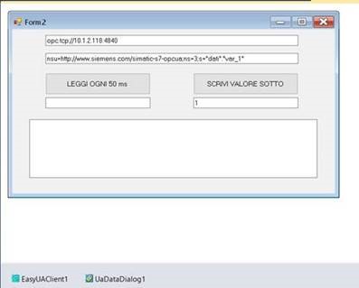

In vb .net 2010 I create a form with EasyUAClient and UaDataDialog.
When I create and use it all run perfectly.
When I close form.vb in designer mode and then want to open it appear this error:
"Precondizione non riuscita: discoveryUriTemplateString!=null
Istanze dell'errore (1)
1. Nascondi stack di chiamate
in System.ComponentModel.ReflectPropertyDescriptor.SetValue(Object component, Object value)
in System.ComponentModel.ReflectPropertyDescriptor.ResetValue(Object component)
in System.ComponentModel.Design.Serialization.CodeDomSerializer.ResetBrowsableProperties(Object instance)
in System.ComponentModel.Design.Serialization.CodeDomSerializer.Deserialize(IDesignerSerializationManager manager, Object codeObject)
in System.ComponentModel.Design.Serialization.TypeCodeDomSerializer.DeserializeName(IDesignerSerializationManager manager, String name, CodeStatementCollection statements) "
If i click to "ignora e continua" it works
what i have to do to correct it?
