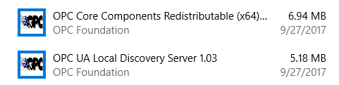

I went here and saw that I needed install (3) things: Microsoft Visual C++ 2015 Redistributable, OPC Core Components 3.00 Redistributable, and OPC UA Certificate Generator utility. I installed all 3:
I added the <appSettings /> from here (it didn't work until I did this).
After doing all that the error went away. I haven't tested it end-2-end with a real server, so I don't know if it's completely working, or not.
