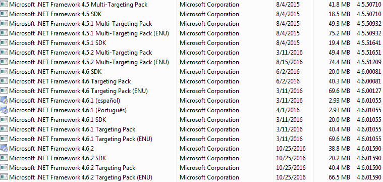

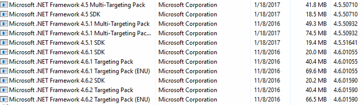

Thank you. Our setup was quite similar, in fact.
I have further tried to reproduce the issue, but without success. I think it may actually be not *directly* related to the .NET Framework version or the target CPU, but rather to things like timing/threads, which are not deterministic and can be different on our computers, even if the software versions are identical.
At this point, unfortunately, I am unable to provide further help, until reproduced on our side.
Do you actually necessarily need to do that? That is, do you really need to build for x64?

02 Feb 2017 08:13 - 02 Feb 2017 08:13 #4910 by Erik
On my dev PC:
1. Windows 7 Professional x64 English
2.
On my target PC:
1. Windows 10 Enterprise 2015 LTSB x64 English
2.
