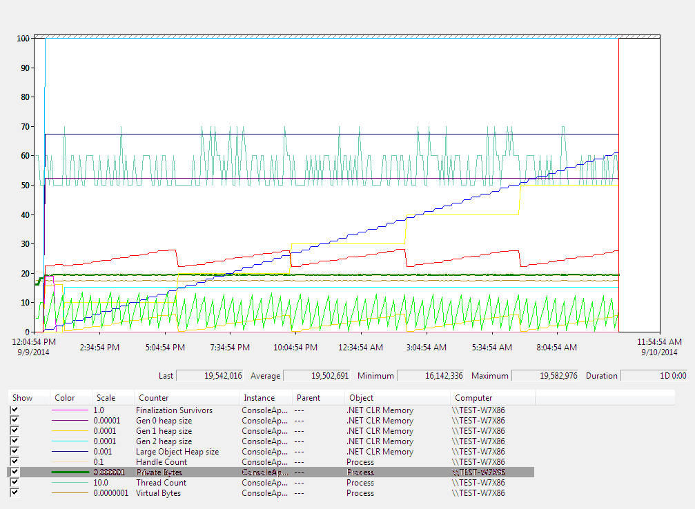

Next, I tested the same project with QuickOPC 5.31.1331.1. Here are the results:
(with approx. 81,200 loop cycles).
There are no signs of memory leak (the thick green line).
My conclusion is that the leak is fixed in Version 5.31. I can kind of guess what has happened - the problem might have been in the area of various EasyDAClient parameter objects, which were originally implemented in C++/CLI, but have been significantly rewritten (with parts moved to C#) in version 5.31.
I do not plan to fix this in versions 5.23 or 5.30 (if it's there).

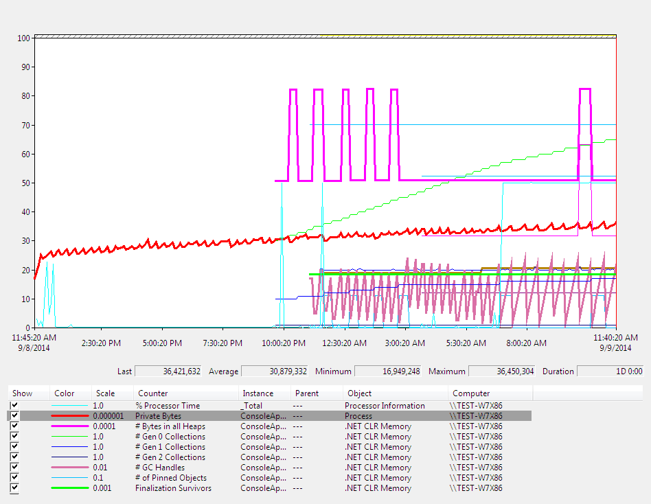

Results of my test with QuickOPC 5.23.1196.1, only EasyDAClient instantiations (project attached):
Some observations:
  • Approx. 149,700 loop cycles throughout 24 hours
  • Increase in "Private Bytes" (thick red line) very roughly 10 MB
  • GC being called by the CLR, no need to invoke explicitly
  • The lower level of "# Bytes in all Heaps" increased by approx. 3 KB (!, from approx. 507,000 to 510,000), the upper level as well
  • Counters like "Handle Count", "Thread Count", "# of Pinned Objects", "Finalization Survivors" show no proof of leak
Last edit: 10 Sep 2014 17:22 by support.
