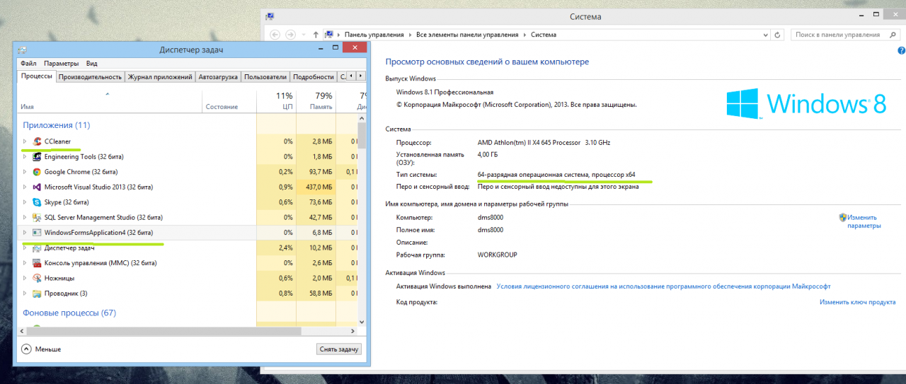

Yes, I agree that it is weird – obviously you have a 64-bit system and some programs are running in 64 bits.
It could be that “AnyCPU” works only because for some unknown reason, it runs the app in 32-bit mode anyway.
But our customers are using QuickOPC in 64-bit processes all the time – usually with AnyCPU on 64-bit systems, but setting the platform to x64 should also work.
Are you sure you have done the platform selection correctly in Visual Studio? Remember there is a solution-wide setting (that’s the one on the toolbar), this one selects it for the solution. Then, each project has the actual platform assigned to that solution platform individually, so in fact it is possible so have e.g. the solution platform x64, while the project compiles for AnyCPU or x86. To be absolutely sure, check Build->Configuration Manager. Things can get messy there.

I don't understand why this is happening.
I have a 64 bit system, as well CCleaner work as 64 bit.
I compiled my program as Any Cpu, then why it works as x86. Look at screenshot.
Probably a problem with me, if you say that x64 is supported, for me that's enough.

I tried to reproduce your problem (on Windows 7 SP1, 64-bits), but was not successful.
When you compile for AnyCPU and run your application and observe its process in Task Manager, does it have “*32” appended to the name of process, or not?
