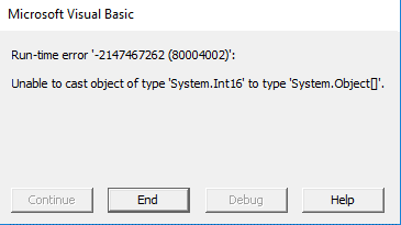

Anyway, using the Array() function to pass empty arrays in place of the unnecessary arguments worked for the customer, they are quite happy, and already purchased the toolkit. Thanks!
GK

There are no optional arguments in COM API of QuickOPC (which is what VBA gets to use). All arguments need to be specified. And, there aren't multiple overloads - for a given method name on an object, such as CallMethod, there is just one set of arguments (this is a general COM limitation).
So, you really need to specify all arguments to CallMethod. This means passing in an empty array if the UA method has no arguments. I cannot test it out right now, but on the Internet I have found that the Array() function might do it (can be given list of elements, but the list can be empty).
Can you please try out something like:
outputs = Client.CallMethod(..., ..., ..., Array(), Array())
The last part of your post is not clear to me. Are you saying that the methods that have arguments do work OK for the customer? In such case he needs to pass in the inputs values and typeCodes similarly to what you have written - so assuming that it works when the methods do have input arguments, I could imagine that passing this to a methods that does not have arguments could lead to an error, but I would expect that be an OPC service error, rather than what you have shown - because he is basically passing in the same as that he is passing elsewhere. Can you somehow elaborate/explain, or provide full examples?

I am working with a customer who is using methods in OPC UA. Initially, we had tried to steer him towards the Excel Add-In, but he preferred to work with VBA due to comfort. This issue is the only thing holding up a license purchase. They are testing with 2020.2.
One of the UA Methods that the customer is using does not have any InputArguments, and therefore, I would expect them to use the overload that omits the input and type, since they are optional arguments. However, in VBA, when these are omitted, we see an "Argument not optional" error.
docs.microsoft.com/en-us/office/vba/Language/Reference/User-...rgument-not-optional-error-449
So my question is, how do we declare arguments of the CallMethod function as optional when the function is not user-defined? Alternatively, is there a way to pass null entries instead?
The customer does have other UA Methods that include inputs, so he does have arrays configured for the inputs and typeCodes. One thing that I suggested he try is include "inputs(0) = False" and "typeCodes(0) = 0 'TypeCode.Empty" as part of his arrays and pass those as the arguments, but that results in the attached error.
Any help would be much appreciated.
