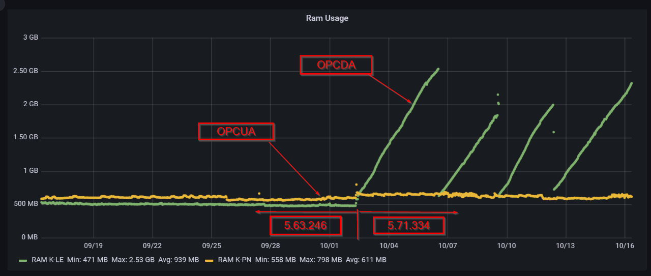

I agree that the green lines on the right side indicate a memory leak.
However the only chart you have provided me as potentially reproducible on my side does *not* show it. This is the middle chart in your original post. Can you make it grown in an unbounded way by increasing the number of signals, the rate, or both?

Hello
This is a graph of the performance of the entire application (30 days).
It compares two instances:
the first instance connects to an OPCDA server
the second instance to an OPCUA server
After updating the library, you can see the change:
We have updated to 5.71.401 with no improvements.
We have updated on another OPCUA server and everything works correctly.

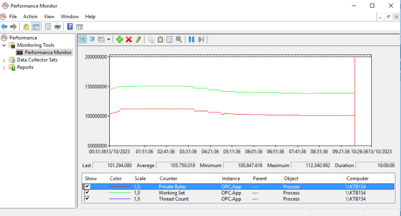

    Using OPCUA there are no problems:

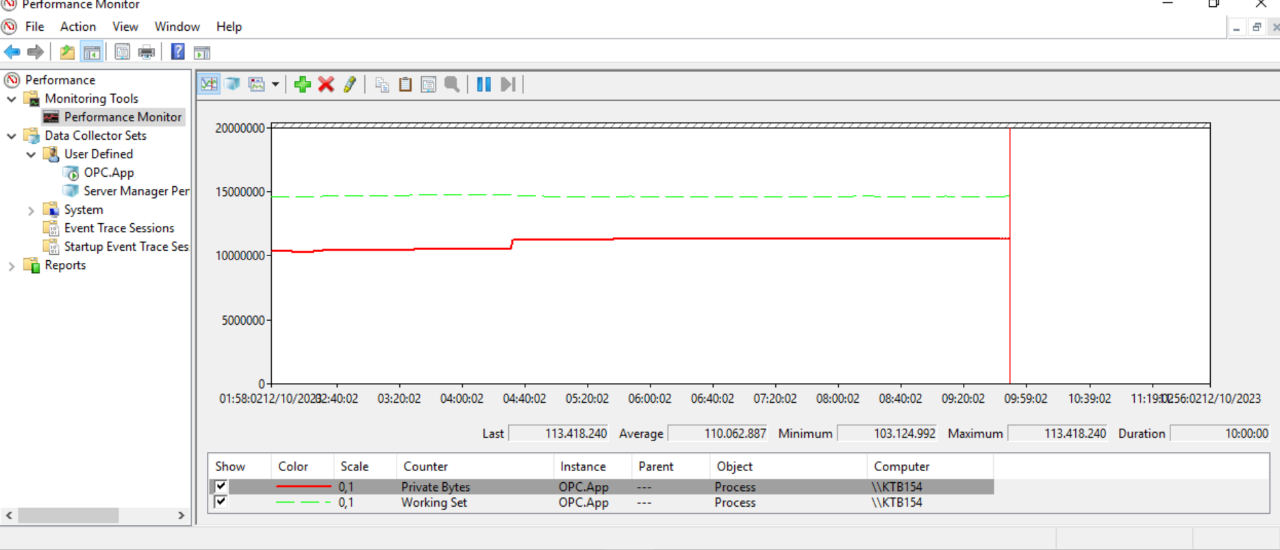

    While on the same machine using OPCDA there is a slight increase (about 50 signals on matrikon simulation server):

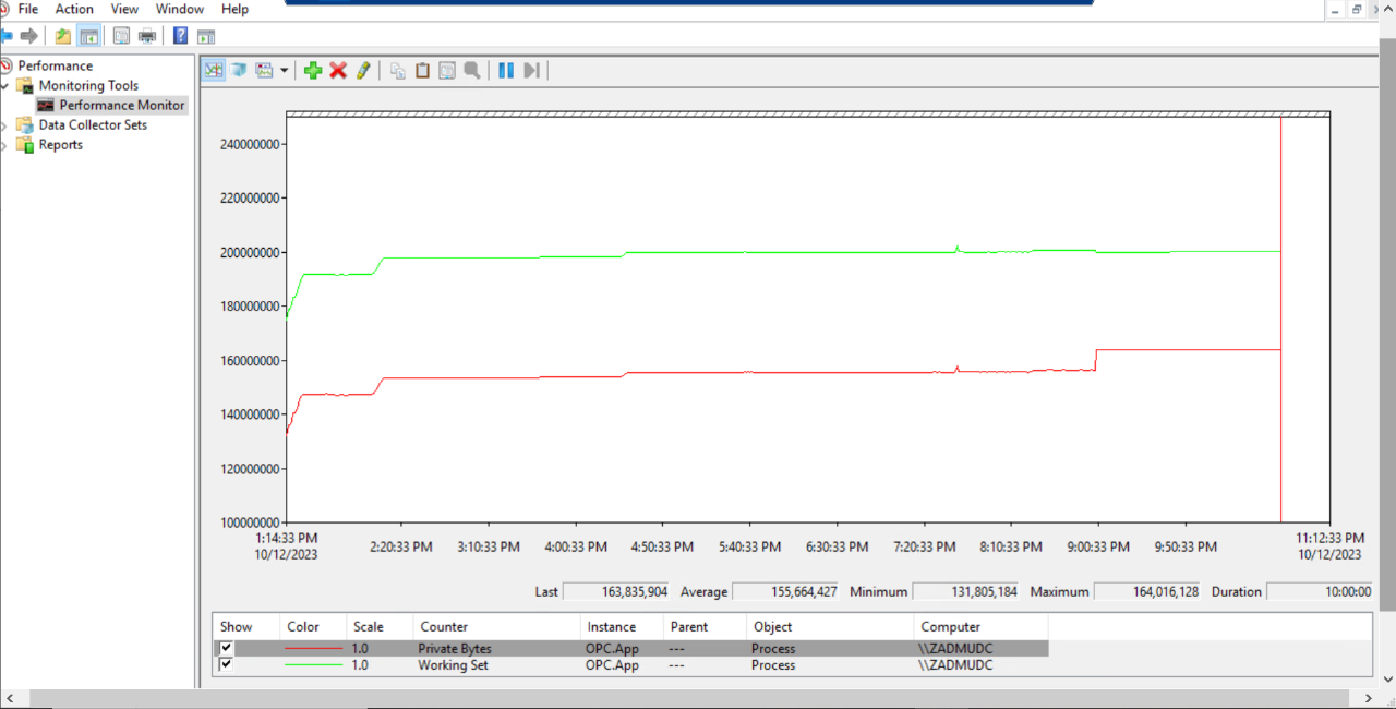

    on a machine that reaches a non-simulated server and reads many more signals, the increase is greater:

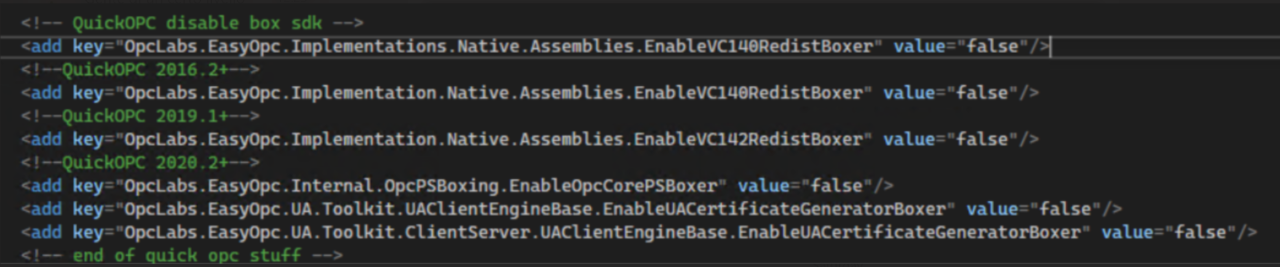

    NB. in the Framework version we had these parameters, which should not be necessary in .net6:
    right?
