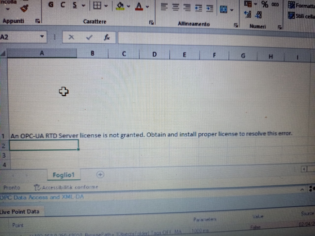

08 Apr 2022 10:26 #10793 by support
Replied by support on topic excel problem with licenses
Please uninstall version 2021.3, and install the current version, QuickOPC 2022.1. Your license allows version 2022.1 too.
In my test, this has resolved the problem.
07 Apr 2022 10:34 #10790 by support
this is to let you know that I have managed to reproduce the "An OPC-UA RTD Server license is not granted..." issue on one computer.
This gives me an opportunity to investigate it. Please bear with me, it will take some time. At this moment, I do not need more information form you.

04 Apr 2022 11:28 #10775 by support
I have received the License Manager screenshot.
It looks like that the licenses are installed correctly.
And, I have installed your license keys and made a test. Unfortunately I was not able to reproduce the problem. Will keep trying.
Can you tell me whether your Excel runs in 32-bit or 64-bit process? Instructions:
1. Start Task Manager (Ctrl+Shift+Esc).
2. Switch to Detail tab.
3. Enable the "Platform column"; Right-click in the table header row (where the Name, PID, Status etc. appear), choose Select columns, scroll down to find Platform, check the box, press OK.
4. Locale EXCEL.EXE row in Name column in the table. What is under the Platform column in that row please?
Additional question: Are you doing this on multiple computers and some work and some don't, or none work, or just doing it on one computer?

02 Apr 2022 08:33 #10766 by baldassarra
excel problem was created by baldassarra
hi
I have a problem when I copy a tag value from quickopc ua in excel.
In the proprety of the comments compare a message that i copy in picture.
Can you help me, please?
B.r.
