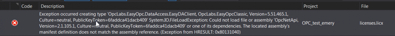

21 Feb 2018 07:44 #6068 by support
Replied by support on topic licenses.licx
There appears to be two related issues.
One is that you probably have multiple versions of the library listed in the error message. If you are referencing it in your project, remove the reference. If you are not referencing it, look for its copies on the computer and remove them, including GAC.
The other issue is that even in the presence of different versions, the licensing system should not get confused like this. This is probably an issue on our side that I will investigate. But I can only do so next week when I am back in the office.
20 Feb 2018 18:35 #6066 by bobday
Replied by bobday on topic licenses.licx
1. Windows Form
2. DAConnectivity
3. VS Professional 2017
4. for error mgs see attachment
Everytime I view the form design tab the licenses.licx file is recreated. I delete it and next visit to the form design tab it is re-created and get the error message again on build. I am stuck is this circle and lost for the solution.
