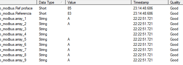

I'm trying to develop one application using Modbus TCP using a Modbus TCP/IP Ethernet channel.
The goal of the application is send one string (10 char) to the Kepware. And at this moment i can send just one char per Holding Register.
For example, for 400001 i load "0x41", for 400002 i load "0x42" ... 400010 i load "0x50" in Hex that means "A", "B", "C","..." in ASCII and then on the tag's of the kepware if i create one tag with HR 400001.2L as string, i can see the "A". But if i create one tag with 400001.20L, i should get 10char, right?
If i use a individual tags for each HR, like 400001, 400002, 400003 ... as string, i can see the respective char for each HR.
So, my doubt/ question is if is possible to read the 10 Holding Registers on the same string or tag?
do you have some idea, how to do it in the same string? It means, in the same tag read "ABCDEFGHIJ".
