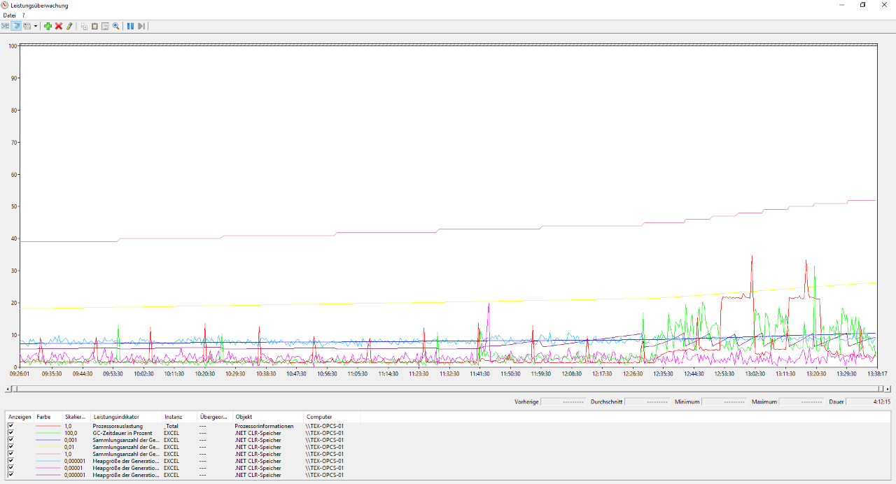

I have received the files (.PNG and .BLG) over FTP, thank you.
Unfortunately I cannot make any conclusion out of it. Your issue was with data refreshing stops in duration for about 5 seconds. As far as I can tell, the performance data have been collected with sampling rate of 15 seconds. So, even if there were some "stops", I cannot see them/distinguish them from "noise".
I would like to the data be collected at least once per second please; maybe 2 Hz would be better. It does not have to cover long duration - just three or so such "5-second stops" would be enough.

17 Nov 2019 10:12 - 17 Nov 2019 10:14 #7975 by support
thank you for this. The PNG is unfortunately not detailed enough, I will need the actual log files.

14 Nov 2019 14:25 #7970 by Enrico
as requested here is the log file of the performance measurement. Let me know is something is missing.
In the meanwhile we moved the Excel-Display onto the main Telemetry Server. That improved the situation dramatically. The log file has been written with the new configuration.
This configuration is OK for a short time workaround (the planned operation is tomorrow), but this will not work as a long time solution, as we would like the Excel-Display to be used for remote stations.
Please let me know if the log file helps or I can do some more tests.
Ciao Enrico
