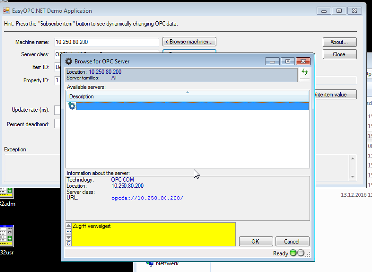

It should also be noted that the screenshot you attached is from a kind of "pre-connection" step: At that moment, the client is not trying to connect to any specific OPC server. It is trying to obtain a list of servers available on a remote machine, using so-called OpcEnum service (which should be installed on the remote machine; usually this is automatic with an OPC Server). This is just to let you know when you will be doing the DCOM stuff, that besides the OPC Server there is actually yet another component in play.

Hello OPC Labs,
Sorry. We made an error in the design of the reference test.
The reference used another Connection method.
But still we dont know what to do. I copyed the example in attachments.
Do you know why we get a Zugriff verweigert -Error?
Alex

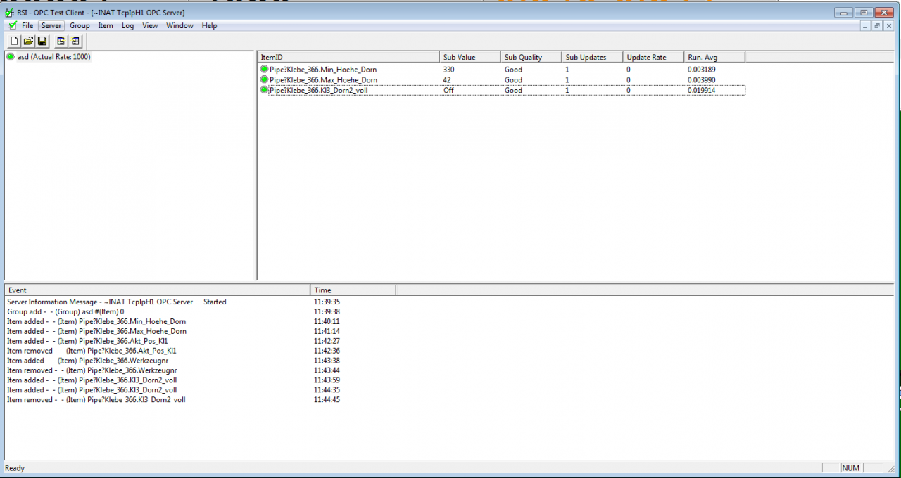

The following error is shown on our Environment reading an OPC Item
16.01.2017 11:35:03 Read Fehler OPC :10.250.80.200-INAT TcpIpH1 OPC Server-Klebe_366.Min_Hoehe_Dorn:An OPC operation failure with error code -2147023174 (0x800706BA) occurred, originating from 'OpcLabs.EasyOpcRaw.DataAccess.RawEasyDAClient'. The inner exception contains details about the problem.
16.01.2017 11:35:03 Inner Exception:Der RPC-Server ist nicht verfügbar.
With another OPC Client i can read the items (see attachment).
What can i do?
Thanks for your help
