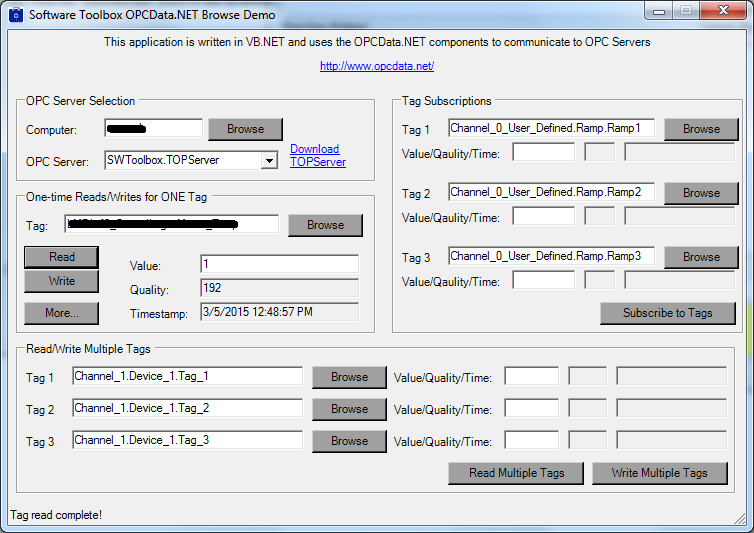

  • saravana48
05 Mar 2015 04:55 - 05 Mar 2015 05:20 #2908 by saravana48
A Security Package Specific Error Occurred was created by saravana48
I have created a VB.NET winform application using QuickOPC Classic 5.12 to subscribe data from OPC Server(remote machine). It has been working without any problems for last 10 months. But now I get the error 'A Security Package Specific Error Occurred'.
I have tested the connection with the OPC server using
1) MatrikonOPC Explorer
2) Software Toolbox OPCData.NET Browse Demo (using OPC Web Client 3.02)
I have able to connect the OPC server and subscripe the tag values withot any error.
The error occurs only in QuickOPC Classic 5.12 application.
