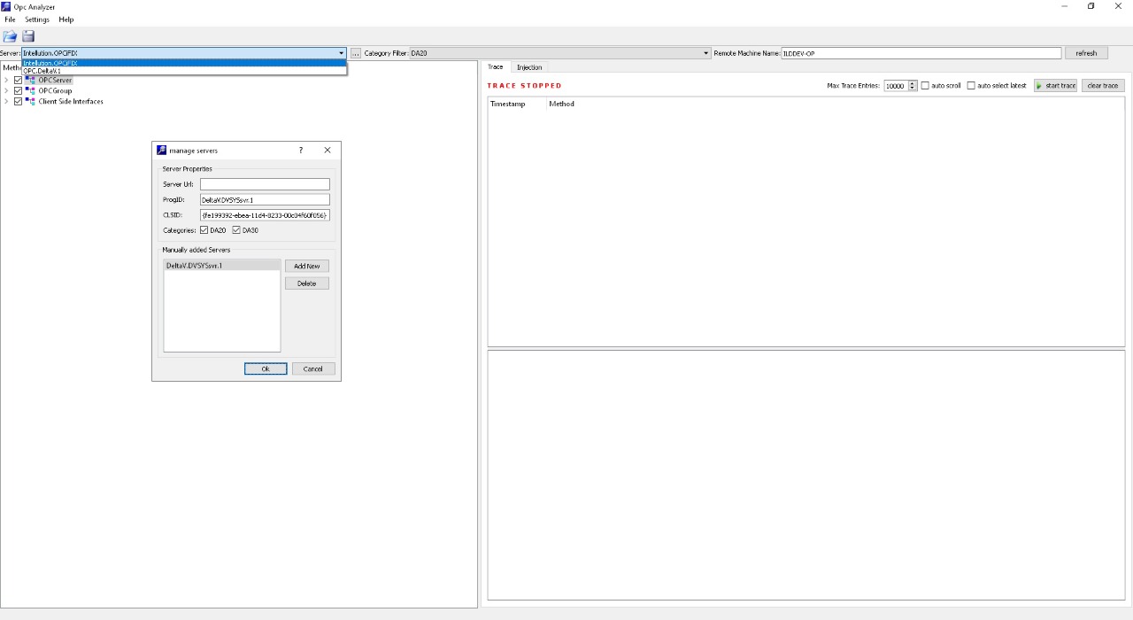

04 Sep 2024 01:00 #13101 by Kyle.Oshima@caltrol.com
Following instructions below for running the OPC Analyzer tool, fourth paragraph states "...[a]fter installing, run the OPC Analyzer, and enter any necessary information in the Category Filter and Remote Machine Name fields, and press the Refresh button. Then, select your target OPC server from the Server drop-down..." however the Server drop-down does not list the target OPC server (see screenshot below)
Please advise what if anything may be mis-configured with tool.
    01 Sep 2024 09:27 #13093 by support
    This means that what I have suspected (double-invocation of the server) is *not* causing the problem.
    At this point there are hardly any options left. About the last thing we can try is the OPC Analyzer. I do not have much hope, though.
    Can you please try to collect OPC Analyzer traces from the "good" and "bad" scenario (and observe whether the use of the analyzer does not change the behavior).
    Instructions are here: kb.opclabs.com/How_to_use_OPC_Analyzer .
    I will send you a download link by email.

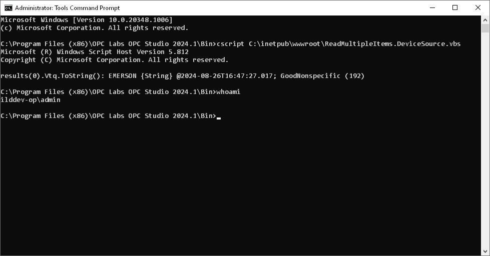

    26 Aug 2024 20:45 #13063 by Kyle.Oshima@caltrol.com
    re: Is the "ADMIN" user of the AppPool the same as the interactive user that is logged in when you made the tests from the console? -- yes, as noted in reply #13047 the IIS AppPool is connecting as Windows user "Admin"; and per Windows command line whoami, console is also running under Windows user "admin" (see screenshot below)
    To eliminate any difference in username specification, as console returns UPN format username (e.g., domain\username) revised IIS credentials explicitly specifying domain\username to match (although IIS successfully authenticates both formats) -- however revised "ReadAndDisplayValue_VBScript.asp" example file still returns same incorrect value of not "ADMIN".
    To clarify, the USERNAME tag has nothing to do with the Windows user; that OPC tag simply posts the DCS user logged on to the DCS -- as noted in reply #13047 the DCS has application-level user definition completely separate from Windows OS user; user accounts may be the same for both the DCS and Windows but is not required. Per the DCS vendor, the USERNAME tag is made available mainly for display of the DCS user on its HMI graphics -- doubt its OPC server has capability to "decide[d] to deliver different results based on who is calling it." To eliminate any correlation between the DCS and Windows users, re-ran tests with the Windows user logged on as "Admin" but DCS user logged on as different user -- console is returning the correct "EMERSON" value as expected; however revised "ReadAndDisplayValue_VBScript.asp" example file still returns same incorrect value of not "EMERSON" (see screenshot below)
    re: is what you meant when you wrote about preventing "client-side browser effect" -- to clarify, as noted in reply #13047 to eliminate any possible html conversion issues (i.e., browser must convert ASP output to be displayed in browser window to html -- specifically how that is done may vary depending on browser) restructured vendor-supplied ASP example file using AJAX (which as acronym means allows server-side "Asynchronous JavaScript [And XML]" to be run outside the client-side browser scope) intercepting the QuickOPC output as-is returned from the object call before the browser's html representation -- however revised "ReadAndDisplayValue_VBScript.asp" example file still returns timestamp and quality but not value.

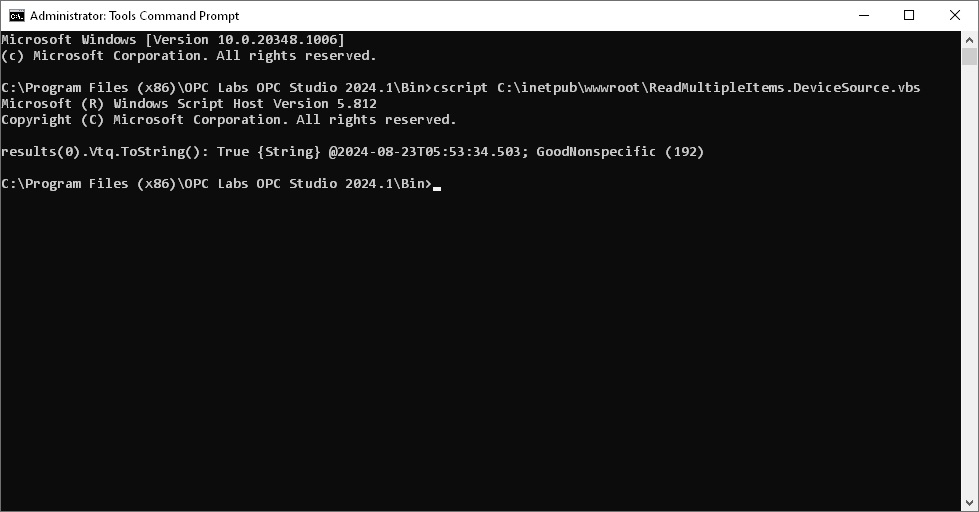

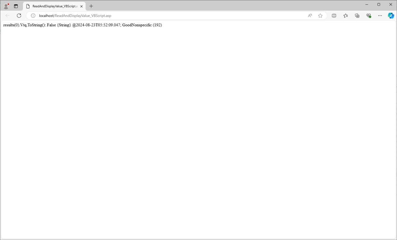

    23 Aug 2024 07:15 #13044 by Kyle.Oshima@caltrol.com
    Some additional test info to help troubleshoot...
    Using the same revised "ReadAndDisplayValue_VBScript.asp" example file from reply #13039 except changing only ReadItemArguments1.ItemDescriptor.ItemID to OPC tag that posts only "True" or "False" values, the IIS/ASP version returns incorrect "False" value (see screenshot below)
    Conversely, the same revised "ReadMultipleItems.DeviceSource.vbs" example file similarly changing only ReadItemArguments1.ItemDescriptor.ItemID to the same OPC tag, the console version returns correct "True" value (see screenshot below)
