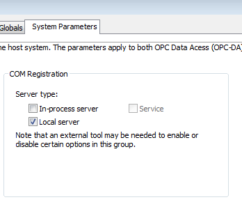

Can you please run the EasyOPC Options Utility (available from the Start menu), and under the "System Parameters" tab, check the settings in the "COM Registration" group? (see picture).
If they do not look like on the picture, please set them as such, i.e.
- "In-process server" unchecked, and
- "Local server" checked
and retest.
