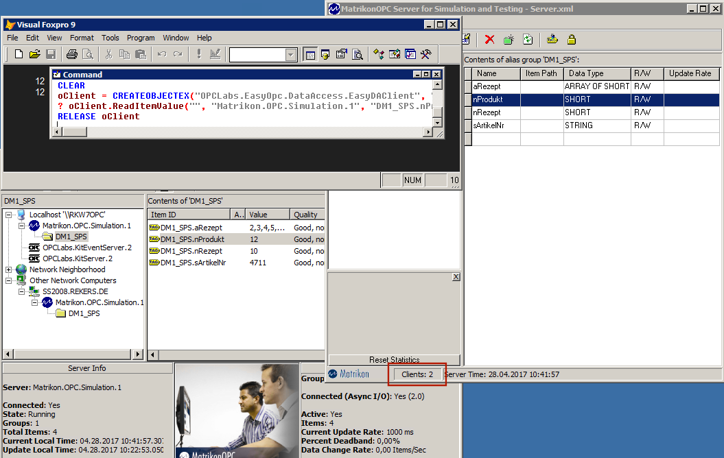

oClient = CREATEOBJECTEX("OPCLabs.EasyOpc.DataAccess.EasyDAClient", "")
? oClient.ReadItemValue("", "Matrikon.OPC.Simulation.1", "DM1_SPS.nProdukt")
RELEASE oClient
Even releasing the Object oClient does not lead to a disconnect.
Matrikon Server still indicates two connections, which is Foxpro and the Matrikon OPC-Explorer.
Quitting Visual Foxpro disconnects from the server.

27 Apr 2017 14:40 #5110 by VFoxpro
Disconnect was created by VFoxpro
I just started testing QuickOPC with Visual Foxpro 9.
After creating a client instance CREATEOBJECT("OPCLabs.EasyOpc.DataAccess.EasyDAClient") the OPC-Server will be connected with the following ReadItemValue().
How can I disconnect from the OPC-Server ? Without quitting the whole application ...
Regards!
