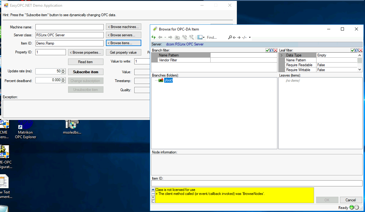

05 Dec 2022 14:45 #11295 by micham
1. It is possible to connect to the customer server directly. When can you connect? I will send you the connection instructions.
2. I tried using the EasyOPC Client ands also couldn't browse. See the attached screen capture. I also copied the exception error . See below.
Exceptions
Type: OpcLabs.BaseLib.Browsing.BrowseException
OpcLabs.BaseLib.Runtime.InteropServices.ExtendedCOMException (0x80040112): Class is not licensed for use
+ The client method called (or event/callback invoked) was 'BrowseNodes'.
OpcLabs.EasyOpc.Implementation.ErrorEnhancement.Processed: True
OpcLabs.EasyOpc.Implementation.DAErrorEnhancement.Processed: True
ErrorCode: -2147221230
HResult: -2147221230 (0x80040112)
Message:
Source:
TargetSite:
XML Qualified Name 2: opcfoundation.org/DataAccess/:E_FAIL.0x80040112
IsEmpty: False
Namespace: opcfoundation.org/DataAccess/
Message: Problem browsing OPC Data Access (OPC-DA) branches.
Source:
TargetSite:

05 Dec 2022 08:58 #11283 by micham
Now we can change the following settings programatically:
EnableNativeClient = True, EnableNetApiClient = False
or
EnableNativeClient = False, EnableNetApiClient = True
However, no matter which option we choose (NetApi-Client or Native-Client) when we try browsing the RSLINX OPC server for items we get an error and the items are not displayed. See the attached screen capture and the error message.
Note: In Matrikon OPC Explorer there is no problem.
Please advise.
