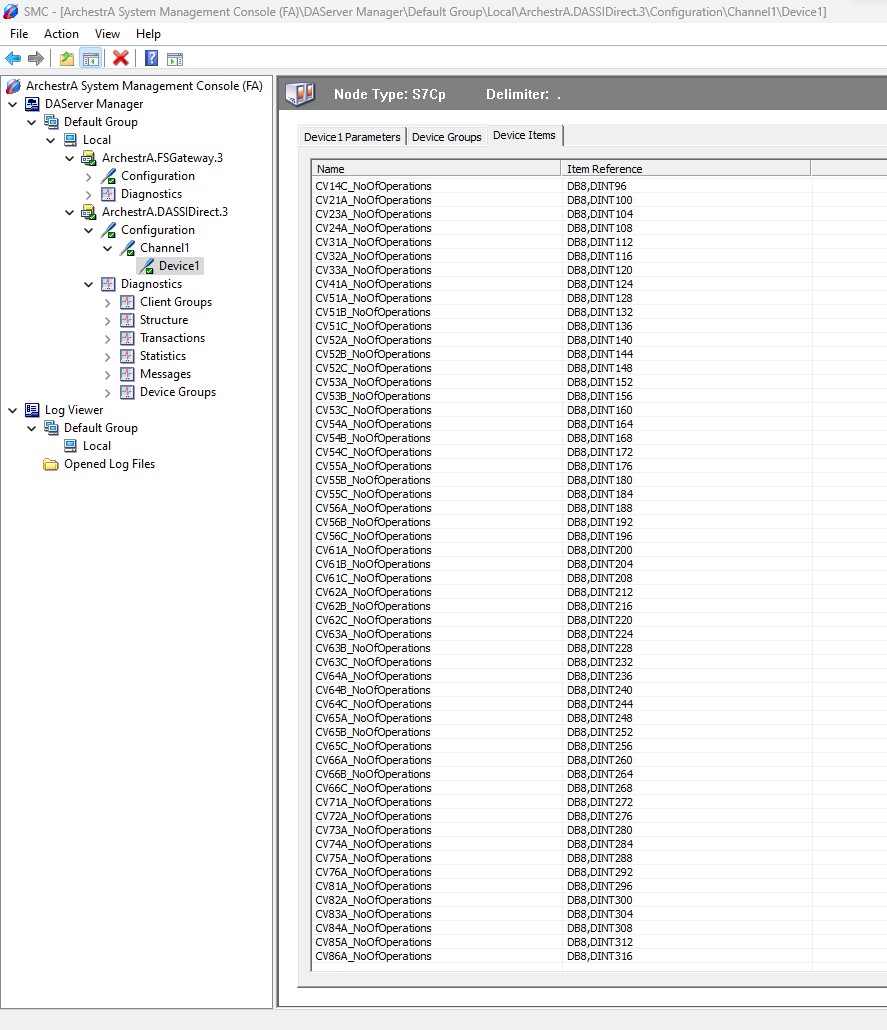

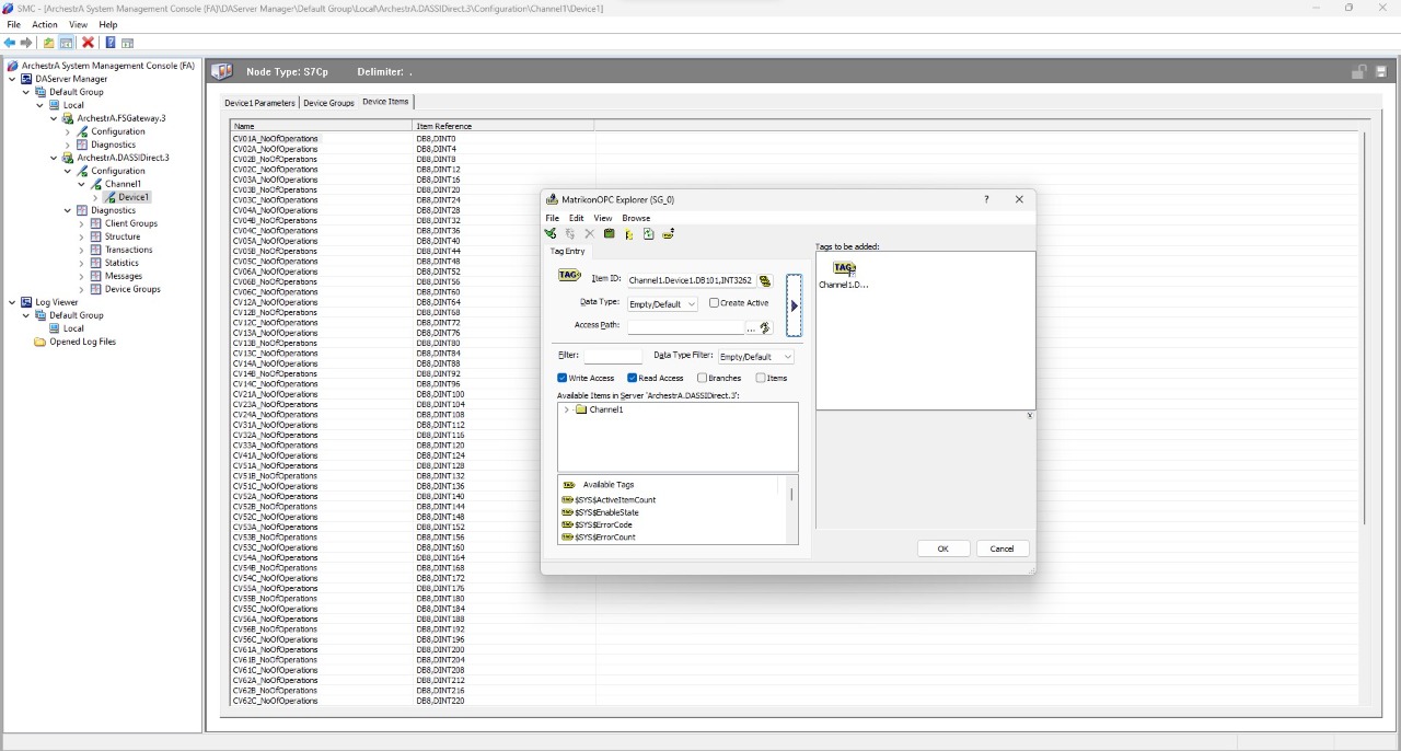

12 Jul 2023 00:39 #11901 by arunmanuel
Let me try to clear up what I mean by not being to able add some tags. I am able to add tags the way you mentioned ie. "You need to select the parent level (Device1 maybe) in the tree view (left side), Only then are the items displayed in the list view (right side), and can be selected and "added"". These tags are those that are present in the "Device Items" tab of Wonderware's System Management Console (SMC). However, on the MatrikonOPC Explorer, I was able to add tags that were not present in the "Device Items" tab of Wonderware's SMC by simply typing in, "Channel1.Device1.<Tag name>". For example, DB101,INT3262 is tag that is not available within the "Device Items" tab but I was able to add this into the MatrikonOPC by simple typing in "Channel1.Device1.DB101,INT3262". I was unable to do something similar on the Connectivity Explorer and was wondering if this is possible at all.

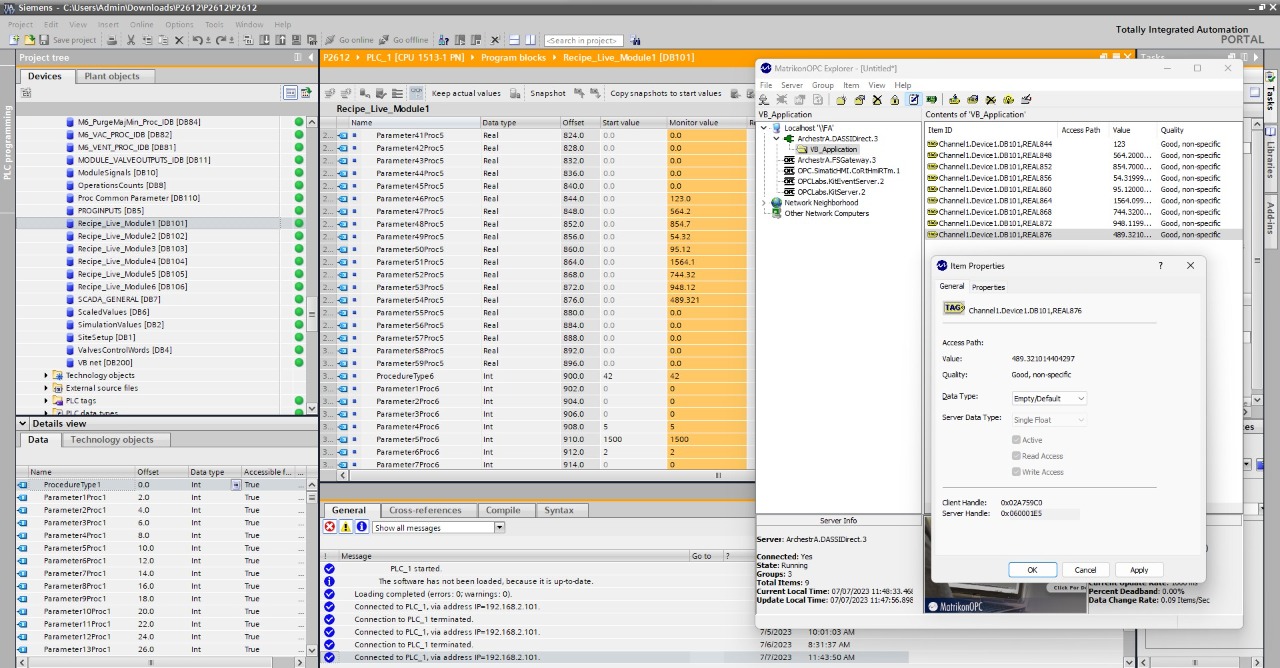

Answers to your questions:
1. I was able to write values directly into the PLC using MatrikonOPC Explorer (image attached). However, I have not tried changing the code of the VB application to use Matrikon's OPC as this is something we would prefer not to do to keep the original code as it is. As mentioned at the start of this thread, I am not the creator of this Application nor am I good at coding with VB application. I was tasked with migrating this project from a S7-300 to S7-1500 but the VB Application and the Wonderware's SCADA remains the same.

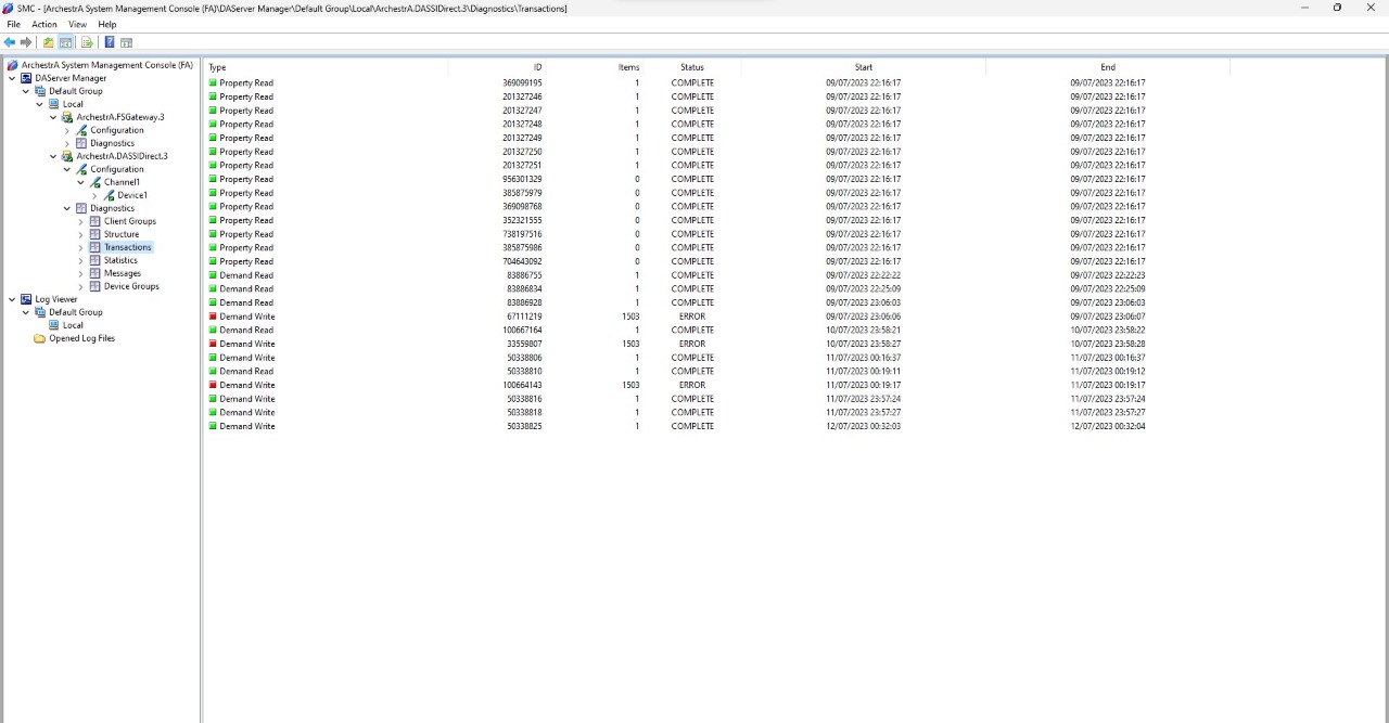

2. With my limited knowledge, I believe it is also reading values from the PLC which I think is working fine. In the "Transactions" section of the SMC, I can see that "Demand Read" is green while "Demand Write" is red and that too only when 1503 items are trying to be written otherwise its green.
3. Yes, this has been done. The value is written into the PLC's DB and there is nothing written in the "Error Message" tab. I have attached the image showing this.

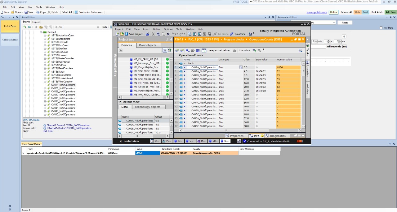

3. Can you please test the writing using Connectivity Explorer? To do so, first "add" the live data row Then, click in the cell under the Value columns, and enter a new value. Then press Ctrl+W (or use the Write command from the context menu). Does it write the value? Does it show something in the Error Message column?

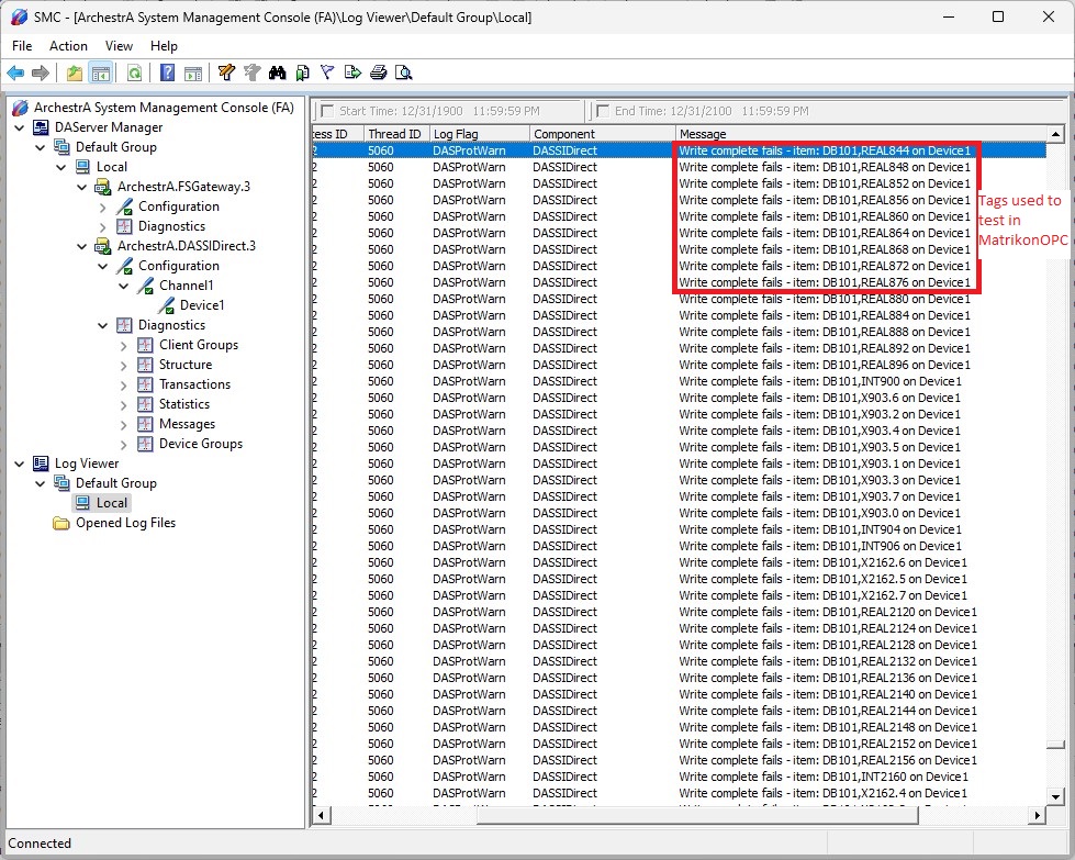

09 Jul 2023 23:15 #11893 by arunmanuel

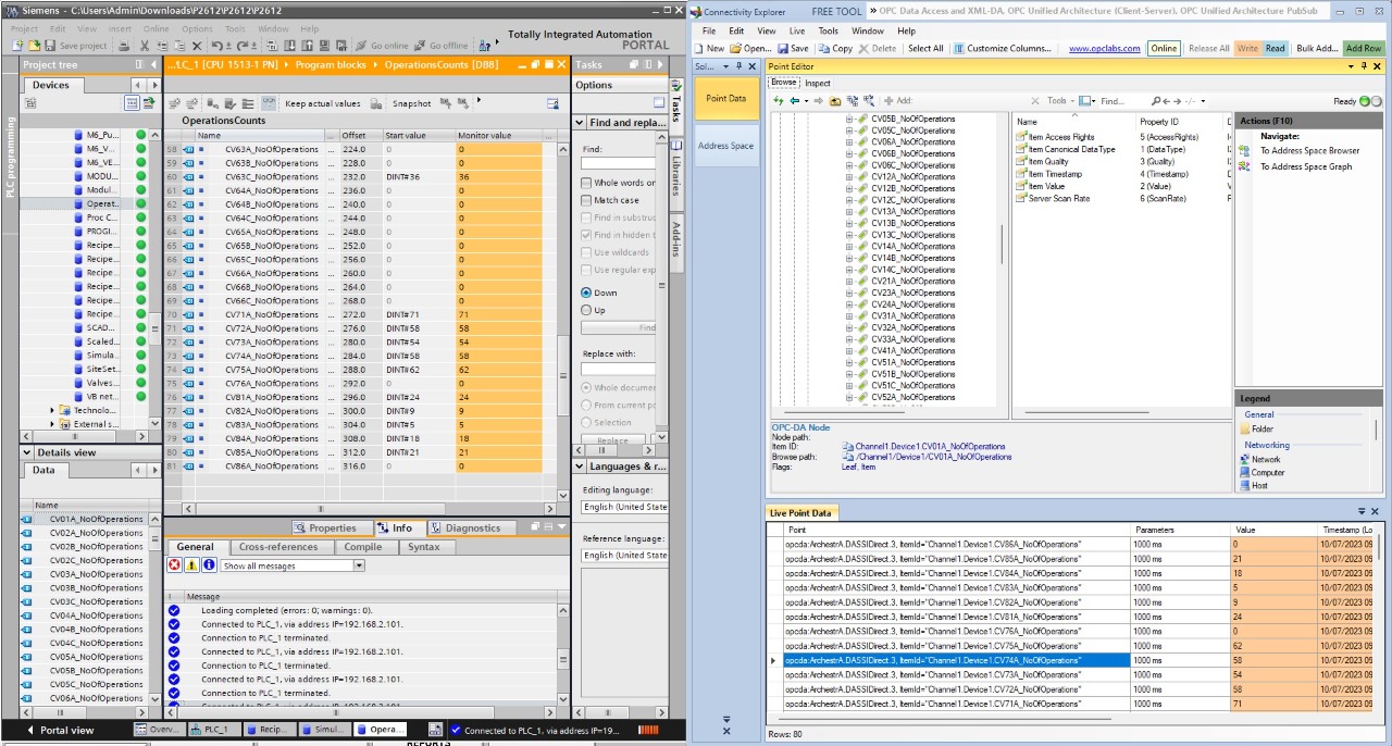

Well, I was asked if I had other OPC client application at hand that I had used to verify the OPC server. Hence, I shared my results with MatrikonOPC. With regards to its results, I believe there has been a misinterpretation. There have been no errors when communicating with MatrikonOPC. As shown in my previous screenshots, the values of the tags in it and the PLC are the same, thus proving that the comms are working fine. The failed error messages in the other screenshot (from System Management Console) were from the earlier time when the write command from the VB application failed. I just wanted to show it to you that the tags that failed during that time communicated successfully during my test with MatrikonOPC.
As per your request, I have tested comms again using Connectivity Explorer. The result (image attached) shows successful communication. However, the thing with Connectivity Explorer is that, I am only able to add tags that are available within the "Device Items" tab within the System Management Console (image attached) and not any other tag. For example, one of the tags that needs a recipe value written into it is DB101,REAL856. I am unable to manually add this tag into Connectivity Explorer. Please let me know if I am missing something here. It is alright if this cannot be done since otherwise also it can be seen that communication works fine with the tags that are within "Device Items".

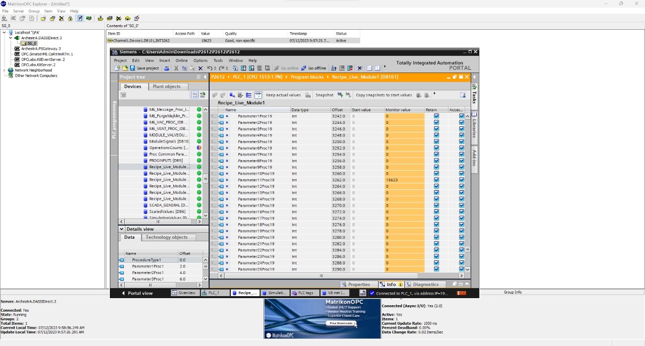

07 Jul 2023 03:51 #11883 by arunmanuel
Yes, I have tried establishing communication using MatrikonOPCExplorer and it was a success. I have attached a screenshot that shows the data being written from the MatrikonOPCExplorer in to the S7-1500 PLC. I have used the same tags that have failed during communication (image attached) from the VB Application into the PLC.

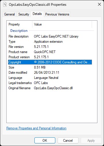

05 Jul 2023 22:44 #11875 by arunmanuel
Thank you for explaining what QuickOPC is and how it works.
I have attached two screenshots which should probably help you figure out which version of QuickOPC is being used. One of them is the QuickOPC setup I installed which was found in the original backup folder of this project and the other one is the Details tab of one of .dll files of this VB application.
Regarding changes to the code, one small change was made to establish proper communication. The original code had instances of "Archestra.DASSIDirect.2" which were all changed to "Archestra.DASSIDirect.3" as this was the name of the driver that was seen in the System Management Console of the Wonderware.

05 Jul 2023 06:48 #11871 by support
QuickOPC is a library, not an application. It has its own settings, but you need to configure them from inside your own code, programatically. Since you have not indicated that anybody has changed the code to modify the settings, and the application has worked and is no longer working, trying to make it work by changing the settings does not seem reasonable, because it is something *else* that has changed and caused the issue, not the QuickOPC settings.
The error code 0xC004D002 could be one of own QuickOPC errors, but it does *not* appear in current QuickOPC version. It could be that it was an error code used in some earlier version, I need to check that. Please let me know which QuickOPC version you are using. The most reliable way to figure it out is to find one of OpcLabs.* assembly DLLs in your compiled application, and in the WIndows File Explorer, right-click the file, select Properties, and on Details tab, there should be the version(s).

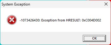

05 Jul 2023 00:58 #11870 by arunmanuel
Seems fair. I was under the impression that QuickOPC had a .exe like other applications that when you open up would have some settings to play around with. But it seems like that is not the case. That's alright.
I had followed your advice and modified the code (attached as a .txt) to see what error message pops up (attached as). I have tried looking up the HRESULT value on the internet but could not find anything on it. Would you happen to have any idea what this means?
