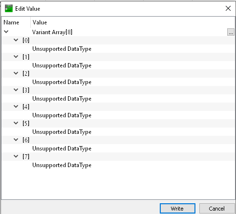

24 Aug 2021 09:56 #10136 by support
Thank you. I was able to extract the files, get the server running, and also run your code and reproduce the issue.
Writing from UaExpert worked well, so I went on to analyze the difference. UaExpert is writing an array of ExtensionObject-s, while QuickOPC an array of Variant-s, each of which contains an ExtensionObject, and this seems to be causing the problem. This looks like a bug in QuickOPC. I will investigate further and let you know when I have an update on the issue.

    18 Aug 2021 13:04 #10125 by goosvanbeek
    QuickOpc 5.61.241
    I'm still struggling with the writing of a struct array. I can read the array objects and alter the values, but when I write the values to the server, the datatype becomes an unsupported datatype.
    namespace OpcUaTestConsole{ #region usings using System; using OpcLabs.BaseLib.DataTypeModel; using OpcLabs.EasyOpc.UA; using OpcLabs.EasyOpc.UA.ComplexData; #endregion public static class Program{ private static readonly UAEndpointDescriptor UaEndpointDescriptor = "opc.tcp://localhost:48030/"; private static readonly UANodeDescriptor UaNodeDescriptor = "ns=2;i=6016"; public static void Main(){ ReadAndSaveArrayData(); Console.ReadKey(); } private static void ReadAndSaveArrayData(){ using(var client = new EasyUAClient()){ var readValue = client.ReadValue(UaEndpointDescriptor, UaNodeDescriptor); if(!(readValue is Array bundleInfoArray)){ return; } foreach(var value in bundleInfoArray){ if(!(value is UAGenericObject bundleInfo)){ continue; } var fieldData = (((StructuredData)bundleInfo.GenericData)?.FieldData); if(fieldData is null){ continue; } var batchCode = ((PrimitiveData)fieldData["BatchCode"]).Value?.ToString(); var bundleCode = ((PrimitiveData)fieldData["BundleCode"]).Value?.ToString(); var boardCount = int.Parse(((PrimitiveData)fieldData["BoardCount"]).Value?.ToString() ?? "0"); var boardLength = int.Parse(((PrimitiveData)fieldData["BoardLength"]).Value?.ToString() ?? "0"); var boardWidth = int.Parse(((PrimitiveData)fieldData["BoardWidth"]).Value?.ToString() ?? "0"); var boardThickness = int.Parse(((PrimitiveData)fieldData["BoardThickness"]).Value?.ToString() ?? "0"); ((PrimitiveData)fieldData["BatchCode"]).Value = "12854"; ((PrimitiveData)fieldData["BundleCode"]).Value = "XYZ-159782"; ((PrimitiveData)fieldData["BoardCount"]).Value = boardCount + 1; ((PrimitiveData)fieldData["BoardLength"]).Value = boardLength + 1; ((PrimitiveData)fieldData["BoardWidth"]).Value = boardWidth + 1; ((PrimitiveData)fieldData["BoardThickness"]).Value = boardThickness + 1; } client.WriteValue(UaEndpointDescriptor, UaNodeDescriptor, bundleInfoArray); } } } }

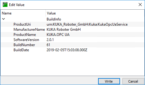

    03 Aug 2021 05:06 #10090 by support
    Yes, I think this is the case.
    Can you please do me a favour? I would like to obtain following information, for improving our error diagnostics in the future: Connect to your server in UaExpert,
    find the Server -> ServerStatus -> BuildInfo variable, put it into the Data Access view, and then double-click in the Value column to display the information, and provide a screenshot.
    That would be very helpful.

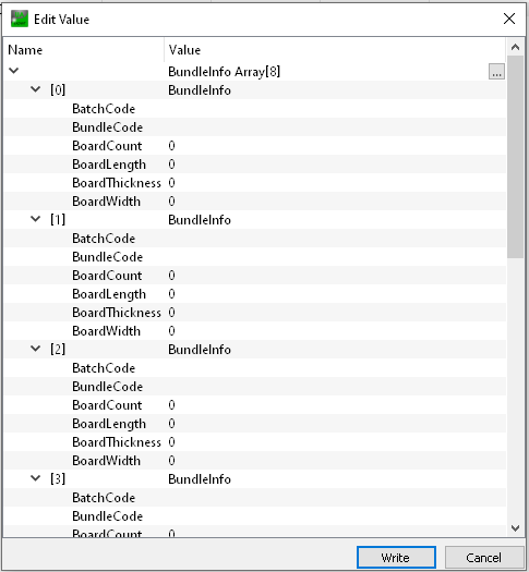

    01 Aug 2021 10:31 #10084 by goosvanbeek
    My bad, I forgot to test with another client.
    So I did a test with UaExpert and the result is a little bit disappointing for me.
    The test also triggered an exception; BadWriteNotSupported (see the attachment).
    It seems that it is not possible to use a structured array with this OPCC server.
    Goos van Beek.
